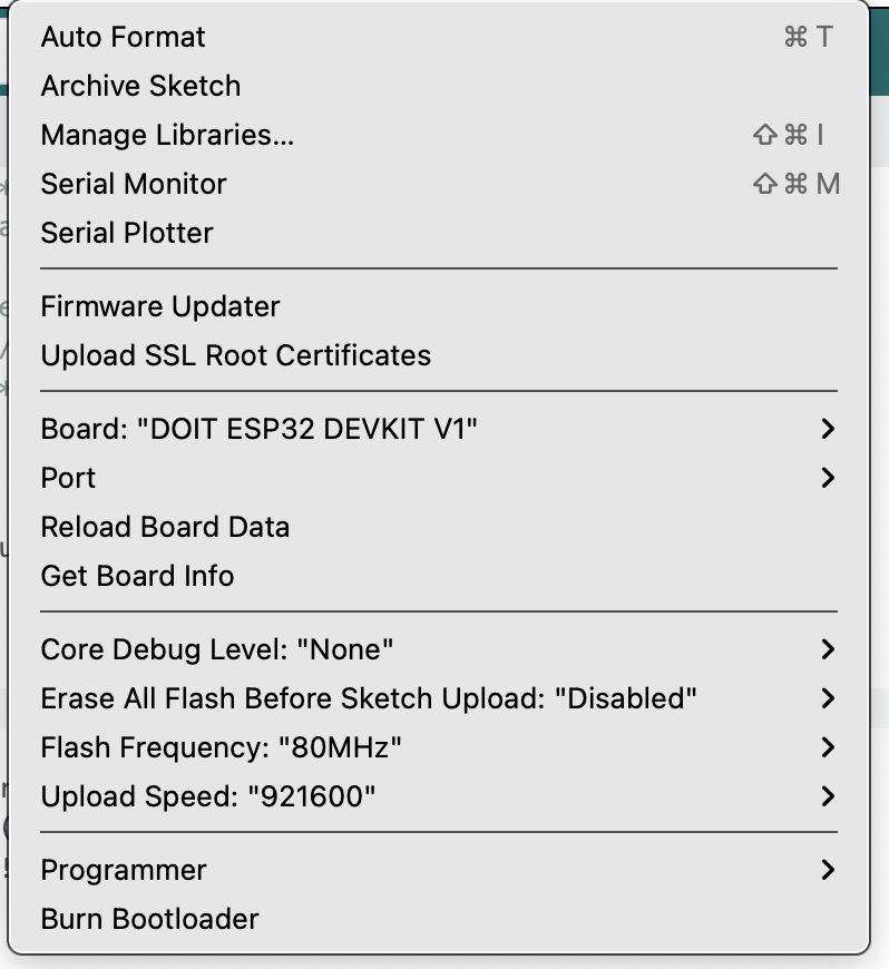

Where do you see that option, I don't see it.
Try selecting Nano ESP32 as the board and you will see a Pin Numbering option
I know, but he didn't say Nano ESP32, I wanted him to realize it wasn't a normal esp32 board.
