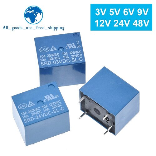

Thanks, so if i am correct, the 74HC595 output goes to the mosfet (FDN337N for example?) which drives the 3v relay?
Will relays like these work:
Then use the TPIC6B595 instead of the 74HC595.
Same function, but with power outputs that can drive a 5volt relay directly.
Leo..
Thanks but it needs a minimum of 4.5v which i don't have, i have a 3.3v ESP32 and 3v relays
Yep, forgot. TPIC is 5volt only.
You could use a level translator between ESP and TPIC.
I would stay away from 3volt relays (high coil current). 32 5volt relays already use about 2.5A.
5volt supplies are more common, and you can easily drop that to 3.3volt for the ESP with a linear regulator.
