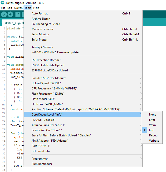

I had this laying around. Not exactly what you proposed, but feel free to convert it into the example you want. The LED On/Off times are all prime numbers. So, you get some good, seemingly random, blink interleaving.
To see the diagnostic prints, set the Core Debug Level to "Info". Otherwise, set it to "Error".
