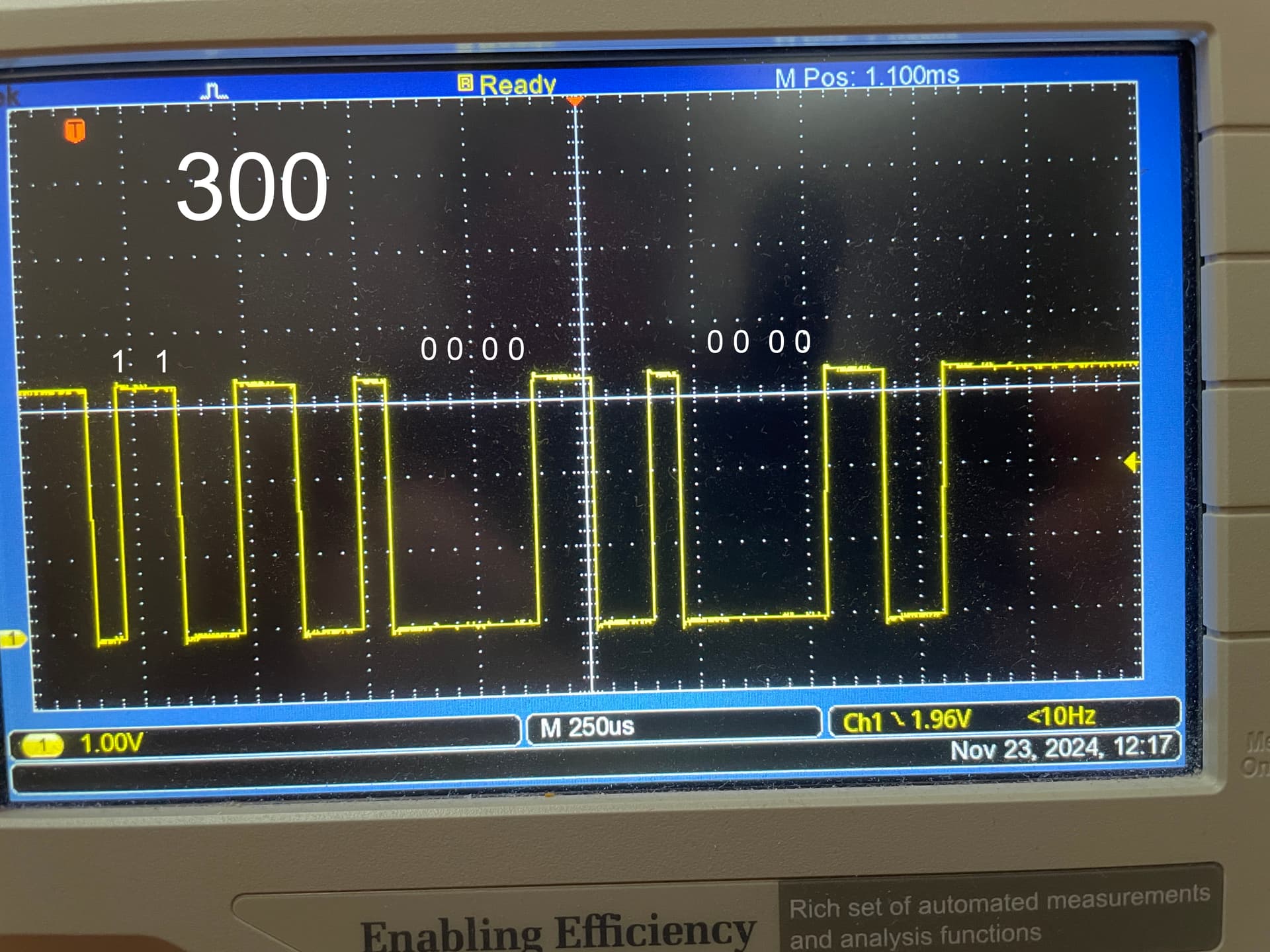

I didn't get far working through all the points, and unfortunately I won't get much more time this w/e. But I did take a series of photos which, I think, substantiate my idea that the coding is BCD, not binary. I did a series of sketches just printing one number: SerialPort.print(x), where x is
198, 199, 200, 201, 202,
298, 299, 300, 301, 302,
numbers chosen to try to show the rolls when the decimal rolls from 9 to 0.
Here are shots of the scope, with my interpretation of the binary values overwritten. The large text in the top left corner is the number being printed in each case.
BCD II:
Serial2 did output data in the same way. When I uploaded the sketch below, I saw '302' on my scope:
