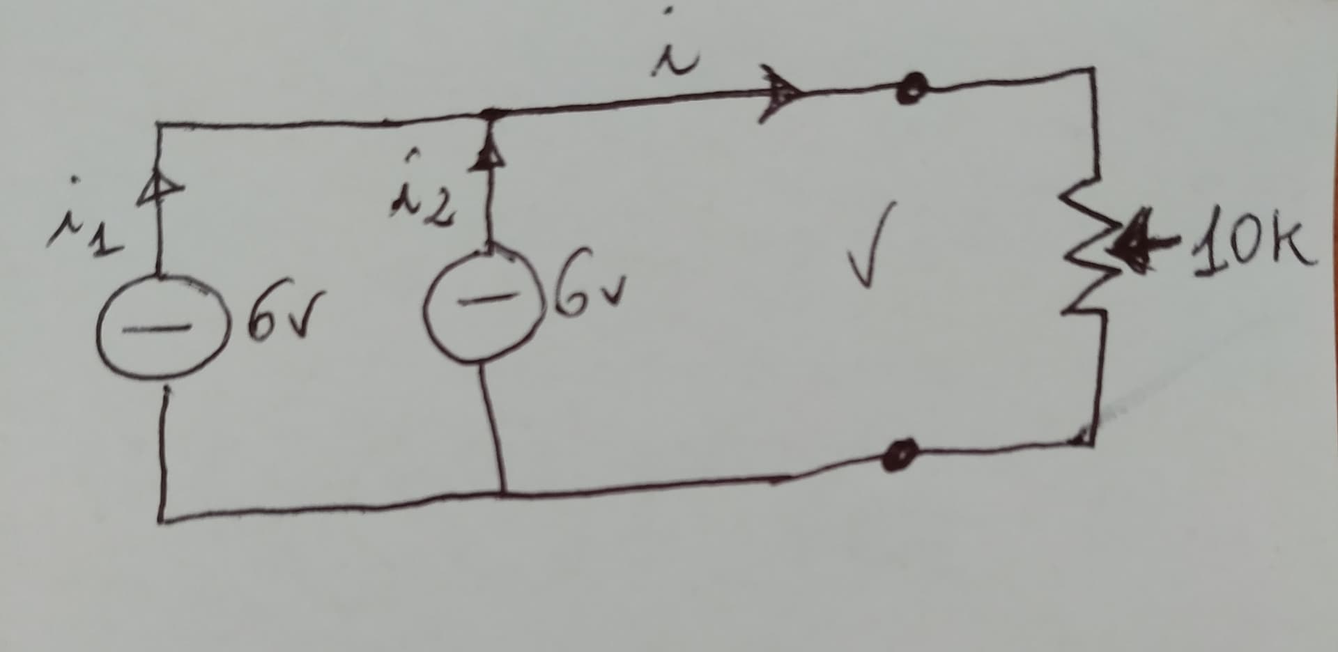

if I have two panels and I want to measure the power generated, can I measure only the voltage with for example a 10k trimmer (which acts as a load) and have P=v^2/R?

If your goal is to measure power with small currents, then sure you can use a 10K resistor.
You can use any value you want.
Yes, I use a trimmer to divide the input voltage to the esp32 (3.3v) which measures the voltage, but I can use the same trimmer as the photovoltaic load and calculate the power as v^2/R
It's correct?
Not sure why you would want to make such a mesurement but yes it is correct.
R would be the resistance between the wiper and ground.
cause i want to measure the power that can be generate all panels
I only have one doubt.. the voltage of the panels in parallel will be around 6 v, regardless of the number of panels. If I calculate the power as v^2/R I will always have the same value.. Maybe is necessary to measure the current i
