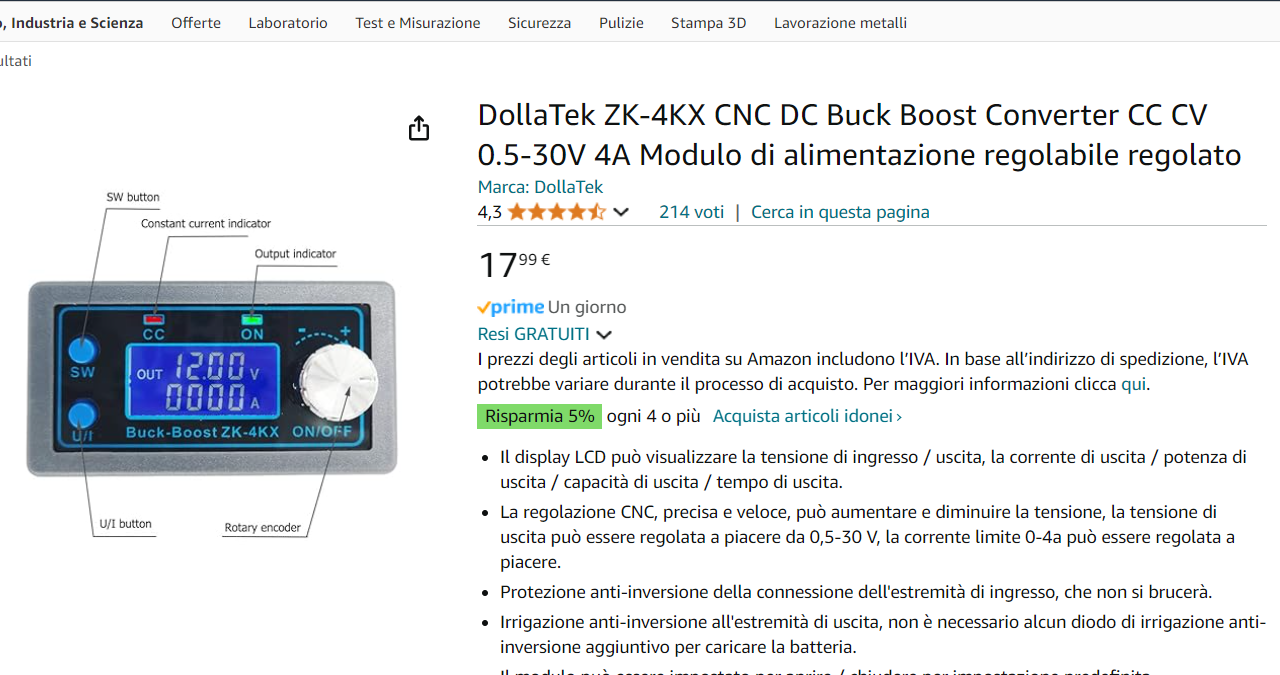

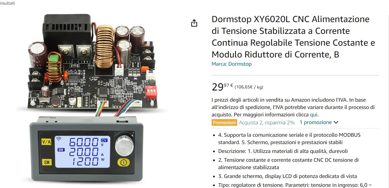

I still don't understand what you are you willing to do exactly, but if you want an easy way to experiment with your panels output, I can recommend some cheap variable voltage/current power suppply like this:
EDIT: I just looked at your panel specs, this converter is little bit small for your panel max output 120W.
This would work.
In your application the regulation of current in dependence of voltage is made by hand or automatically (commercial mppt) during the day?
About XY6020L device i have to put panel voltage in input and setup voltage ref to Vmpp? Device regulate current in dependence of panel voltage varations.
Mine is automated.
I'm not proposing you to invest $30 for that power supply, if you don't need it for anything. But it's easy way to regulate load and observe how panel responses. And according to specs, you should be able to use it with 4-5 12V panels in series
You should put one panel in input, some load in output (for example 12V, >150W heating element or halogen lights)
Set output voltage to 10V (since xy is step down converter)
Set output to CC mode and start raising current up from 0, following output power on display, continue raising output current until output power doesn't raise anymore and starts going down. That's your max power point. Now if you set the display to show input voltage, you will find your real Vmpp
Might be completely useless for you, if you explain what's your target, I can give better suggestions.
