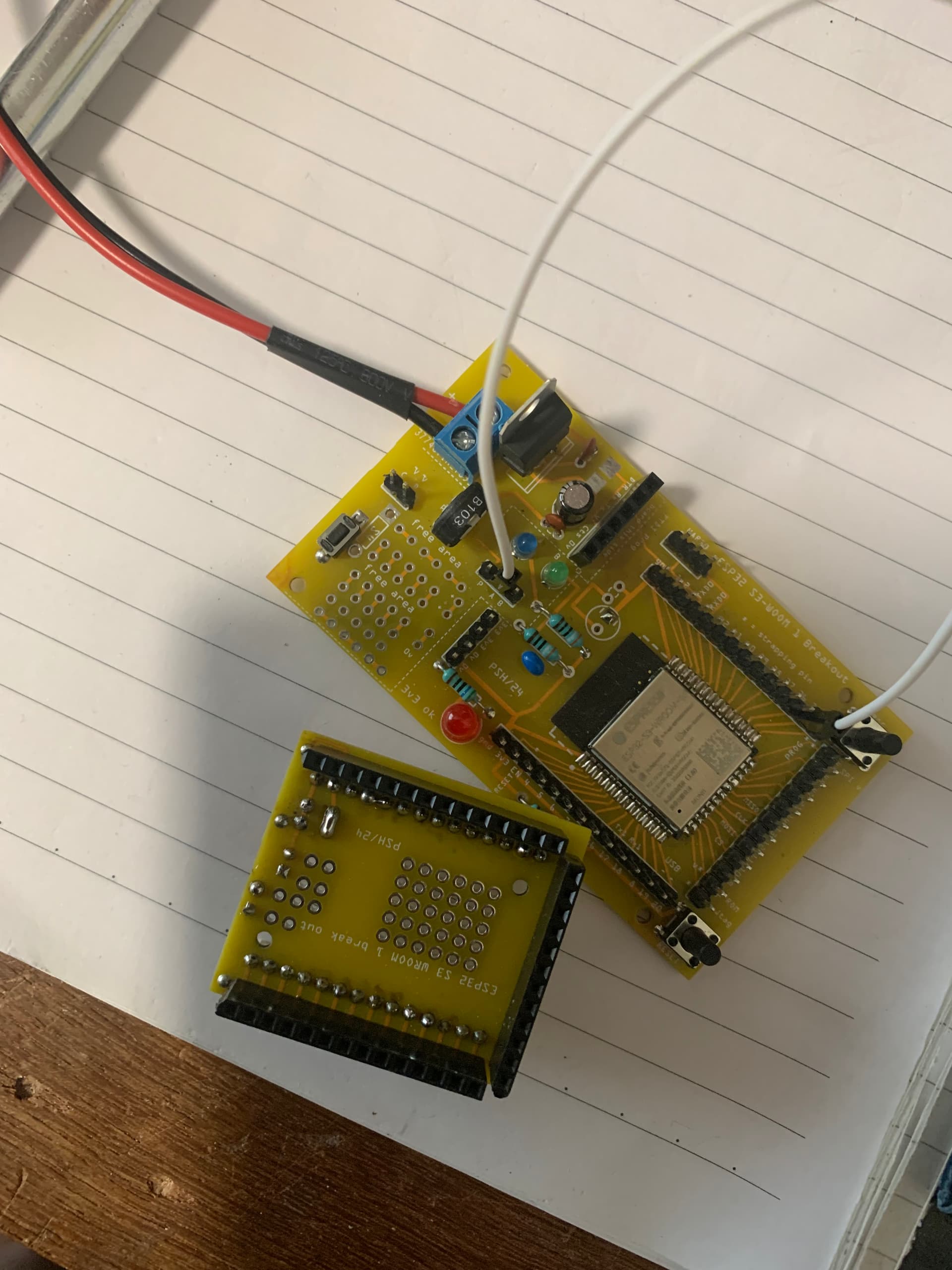

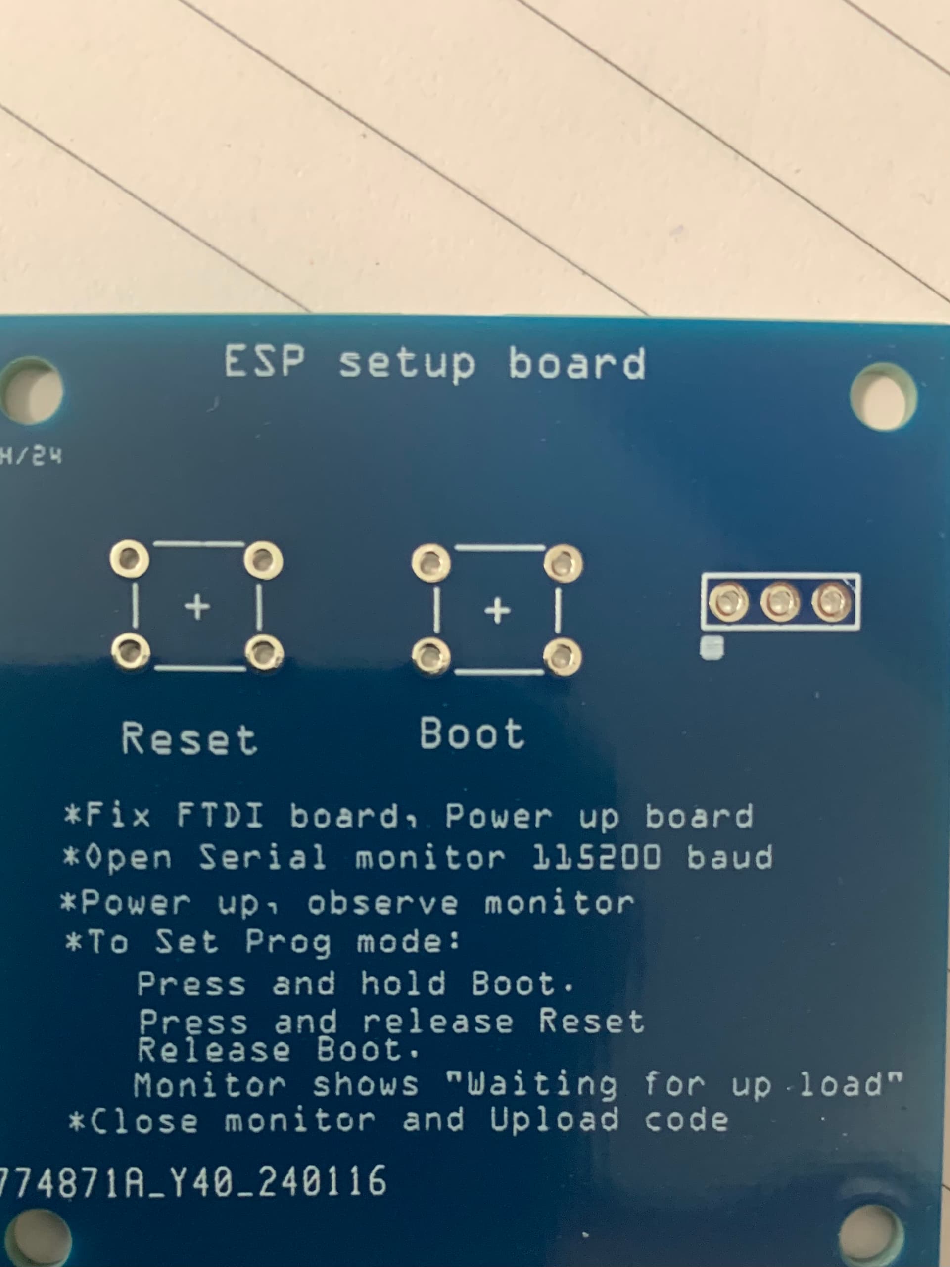

You could always wait until you’ve put the chip in circuit and have a small board with an Ftdi programmer and couple of push buttons connected to a socket on your board built for that purpose .
I’ve made up an experimenters board for that , then build another chip into the final job and program it there ( always useful to be able to update at a later point ).
I didn’t find anything like you were looking for but the spring clip thing you have seen may work , even if all of the I/O doesn’t match that particular chip or you can hack it to make a programmer .
If you look at the pin outs for that modules chip type and your chip and see if the power supply , Tx, rx , EN and Reset pins are in the same place if so it might do the job .
As an example I have this board to connect to my final PCB with a 3 pin connector and an Ftdi board connected to the Tx/Rx/Ov ( set to 3.3v!)
Might have the txt wrong !

I made myself a little chart showing where the pins went on the wroom on the springy thing - not perfect , but as I said I make the projects now so I can get at the programming pins .
