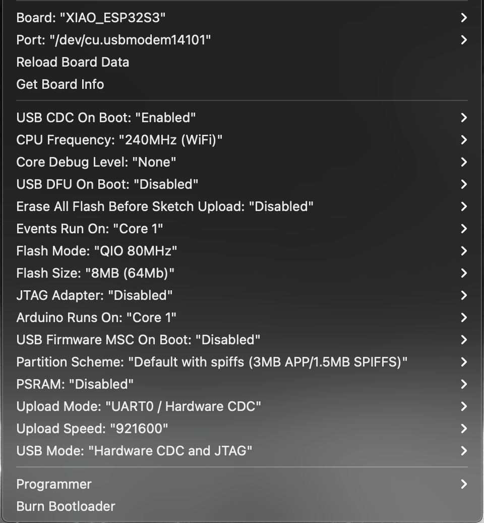

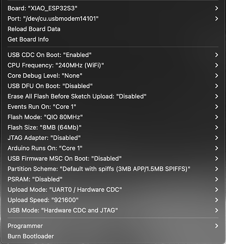

Does the error occur with a simple "Blink" sketch that doesn't use serial?
Or you may need to check the settings under Tools.
Although I am using a Mac in my case, I will share the settings under Tools for your reference.

Yes it occurs in any code regardless if it uses serial or not. I used the same Tool settings which is the default for this board.
