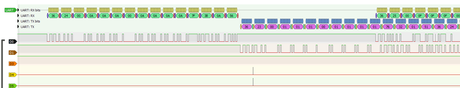

Hello,
I need to copy serial data as soon each caracter arrives.
I have much troubles with latencies during reads and writes.
Here is my sketch... pretty simple. I've just added IO output to monitor read/write operations with a logic analyzer.

First issue : the available() returns only after the full data packet is recevied (see D0 line for source data, and D4 for available() starting to read data), and not when each caracter arrives. Can this be changed ?
Second issue : the write output is very delayed. The latency is so important that the visible data packed sent (D1) is the previous packet (check the second byte in the packet : 24 read / 23 write). The write() operations can be observed on D5. Why is that ?

flush has a really weird effect.
I read and understood it should only affect the TX (force send), but clearly, it doesn't more than that. The RX seems affected too.
https://koxx3.fr.eu.org:8086/smartlcd/Capture4.PNG

Here is the result with flush() as you suggested.

WHOOOO !
I found this thread :

And I patched this file with the recommandations :

Now, this is simply PERFECT !
I use another SoftwareSerial for the LCD_TO_CNTRL.
It works as good as HardwareSerial but it use much more CPU (and partially blocking).

// log_i("Free PSRAM before String: %d", ESP.getFreePsram());
for ( ;; )
EventBits_t xbit = xEventGroupWaitBits (eg, evtReceiveSerial_LIDAR, pdTRUE, pdTRUE, portMAX_DELAY);
if ( LIDARSerial.available() >= 1 )
while ( LIDARSerial.available() )
OneChar = LIDARSerial.read();
if ( BeginSentence )
if ( OneChar == '>')
if ( xSemaphoreTake( sema_ParseLIDAR_ReceivedSerial, xSemaphoreTicksToWait10 ) == pdTRUE )
xQueueOverwrite( xQ_LIDAR_Display_INFO, ( void * ) &str );
xEventGroupSetBits( eg, evtParseLIDAR_ReceivedSerial );
BeginSentence = false;
strncat( str, &OneChar, 1 );
if ( OneChar == '<' )
strcpy( str, ""); // clear string buffer
BeginSentence = true; // found beginning of sentence
} // while ( LIDARSerial.available() )
} //if ( LIDARSerial.available() >= 1 )
xSemaphoreGive( sema_ReceiveSerial_LIDAR );
// log_i( "fReceiveSerial_LIDAR " );
// log_i(uxTaskGetStackHighWaterMark( NULL ));
free(str);
vTaskDelete( NULL );
} //void fParseSerial( void * parameters )
Note the use of if ( LIDARSerial.available() >= 1 ) and not if ( LIDARSerial.available() > 0 ). I found that with the DUE, STM32 and the ESP32 if ( LIDARSerial.available() >= 0 ) does not work as well as if ( LIDARSerial.available() >= 1 ).
