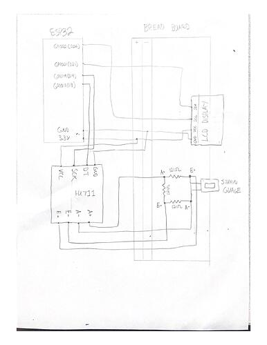

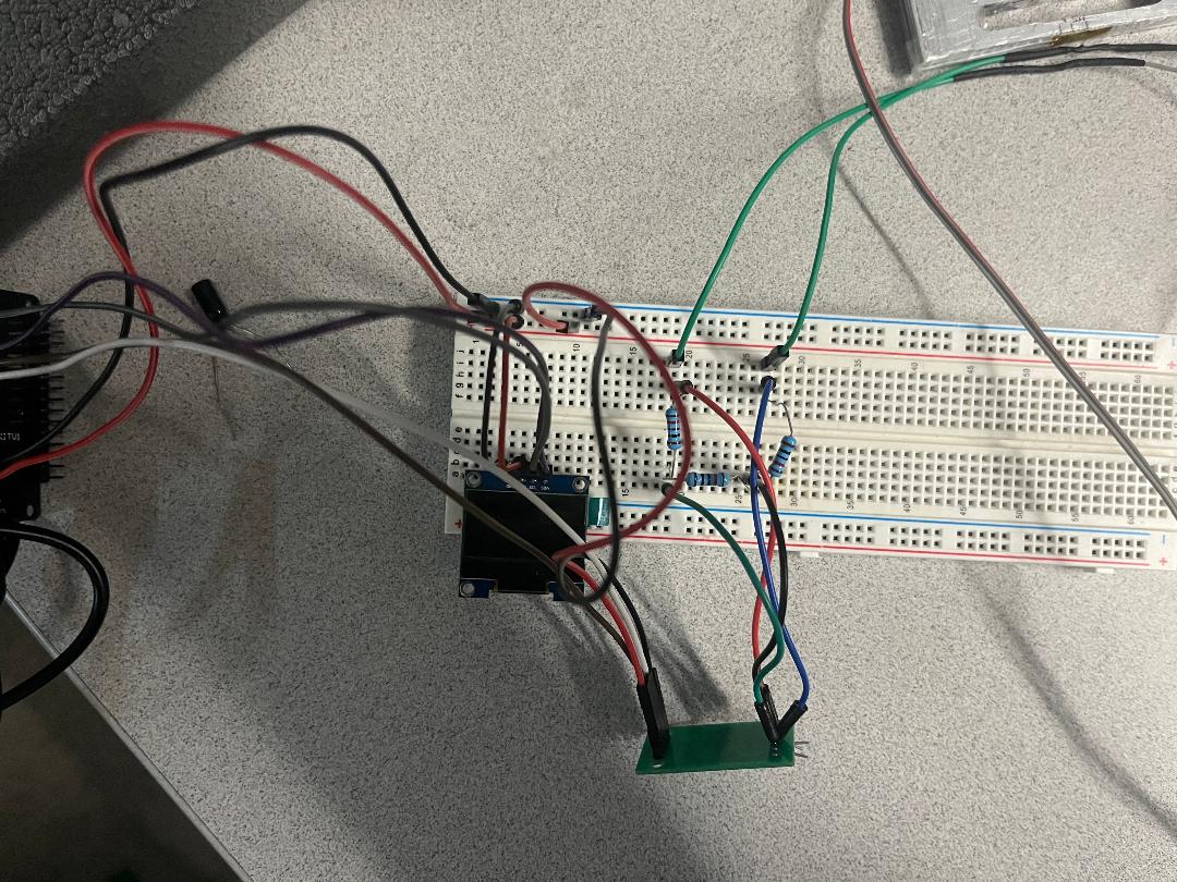

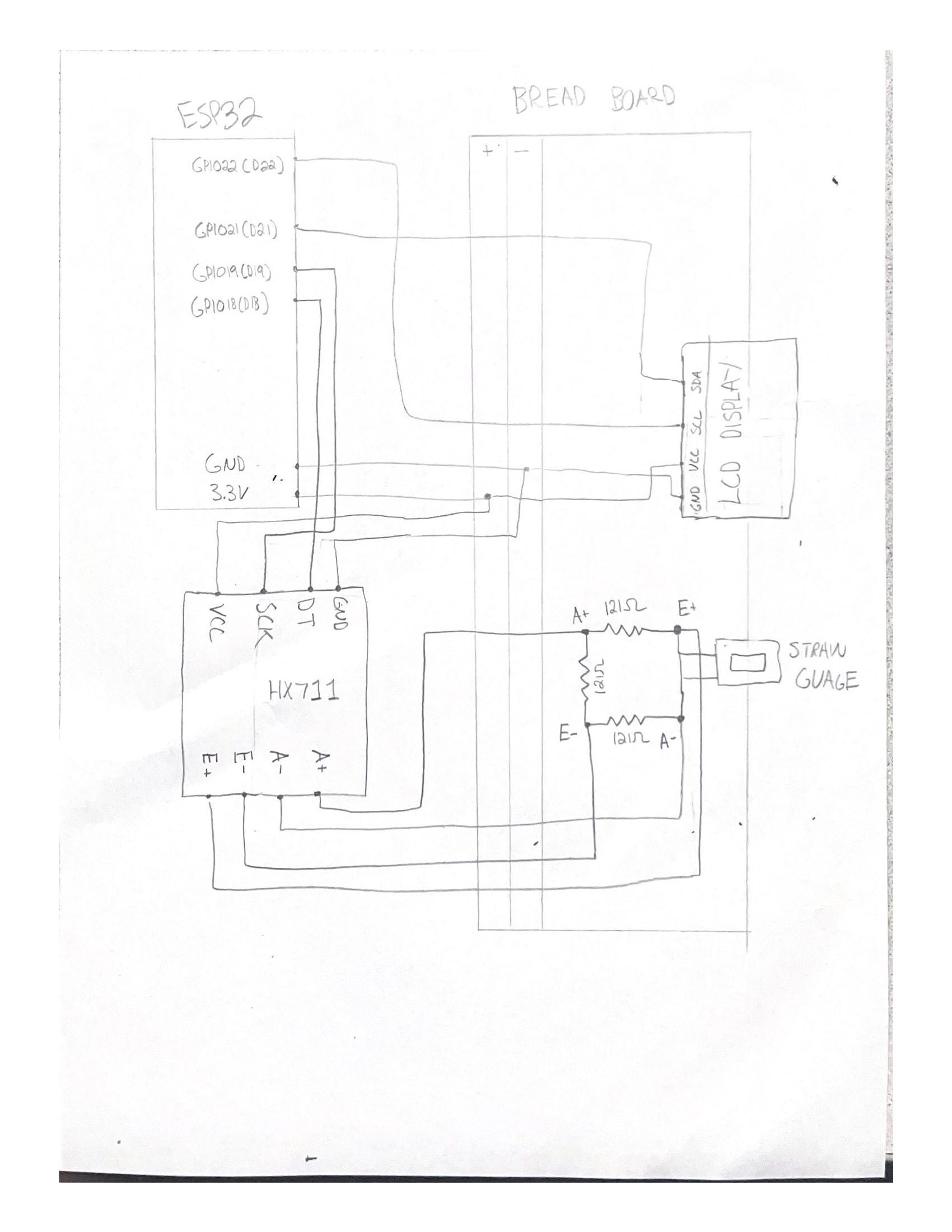

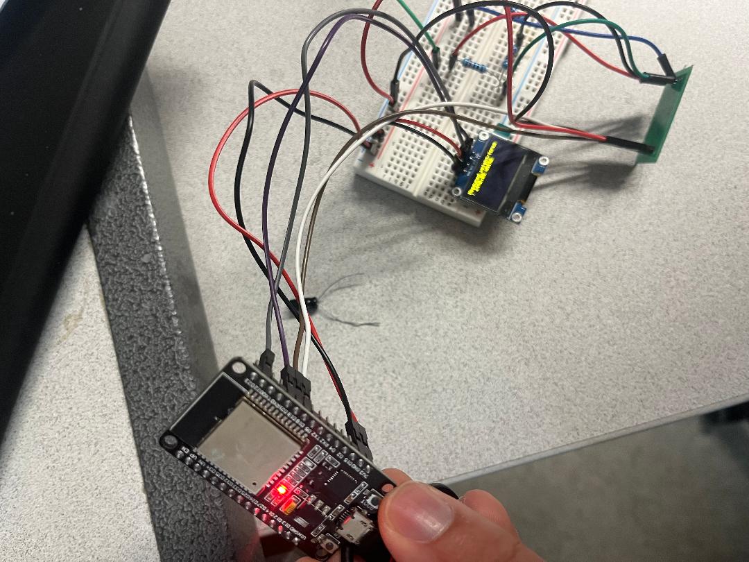

I am looking at making a strain gauge with an ESP 32, Wheaton stone bridge made up off 121 ohm resistors, a 121 ohm strain gauge and HX711 amplifier. When I upload my code I get sporadic values or values the will steadily increase or decrease. I have included my code and some wiring diagrams:

How sporadic? Within accuracy and drift specs for the unknown gauge?
That is normal for a set-up that use long wires, solderless breadboards and cheap gauges.

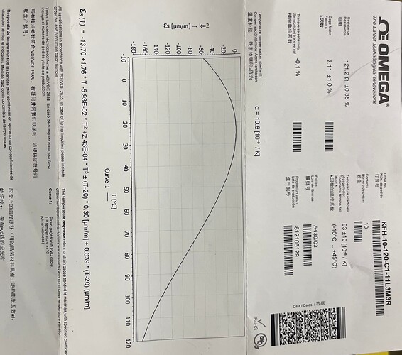

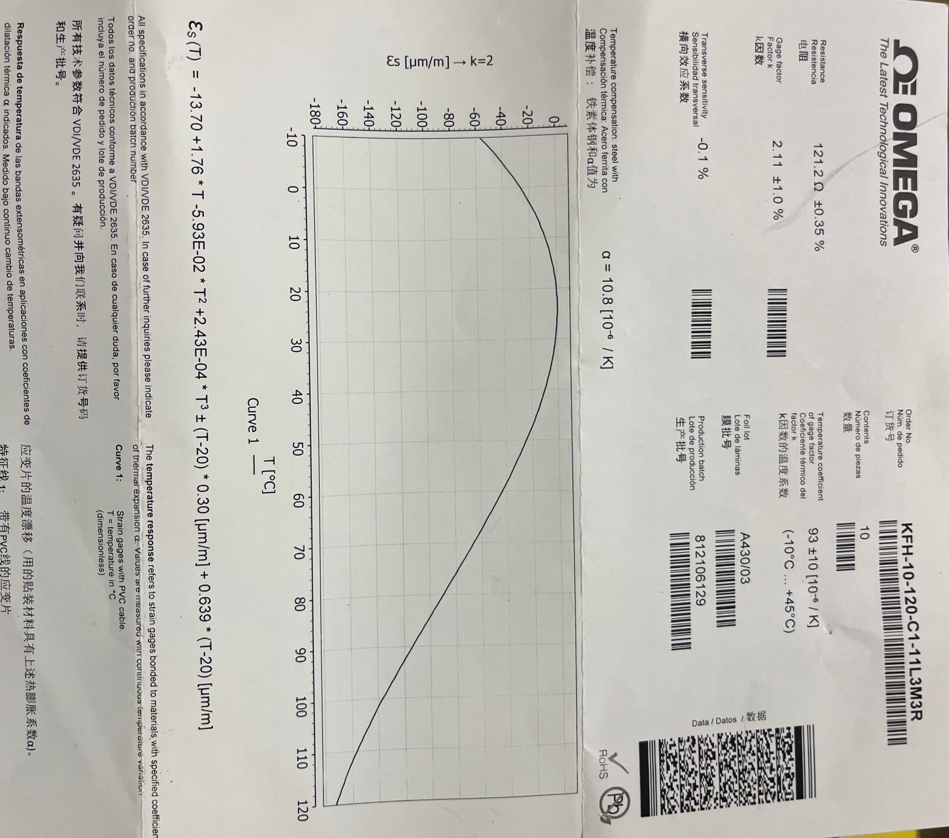

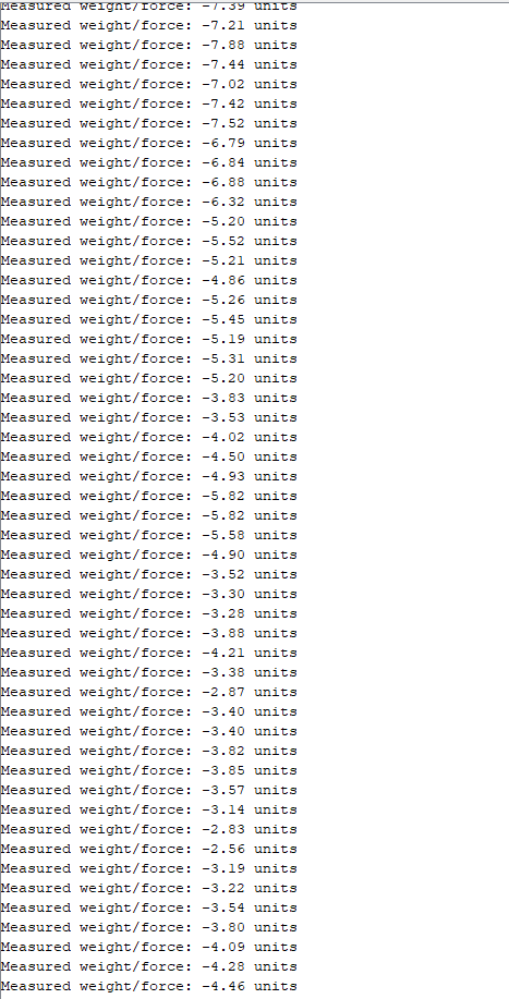

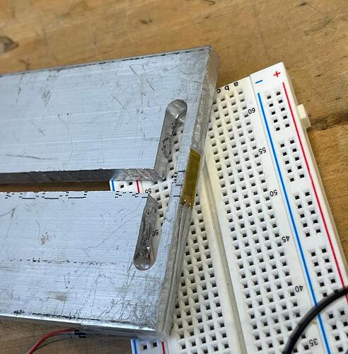

I have included a photo of my serial monitor and the strain gauge data sheet. The values hover around zero, but after a minute or two, they steadily increase.
Is the strain gauge mounted?
Replace the image of the serial monitor data with text of the data in a code block.
Yes it is
The three resistors and the guage are all sensitive to changes in temperature, so that is why you have the drift. As previously mentioned, your set-up just makes things worse.
Do you have any recommendation how to reduce the drift and noise in the system
If you are trying to make precision measurements, then use a dummy gauge to compensate for the strain gauge temperature drift and use low temperature coefficient precision resistors.
If you are just trying to see if something is bending, then just take zero strain measurements as often as you can, average them and subtract that from you strain measurement.
In either case, don't use a solderless breadboard and keep all wires between the gauge and amplifier as short as possible.
