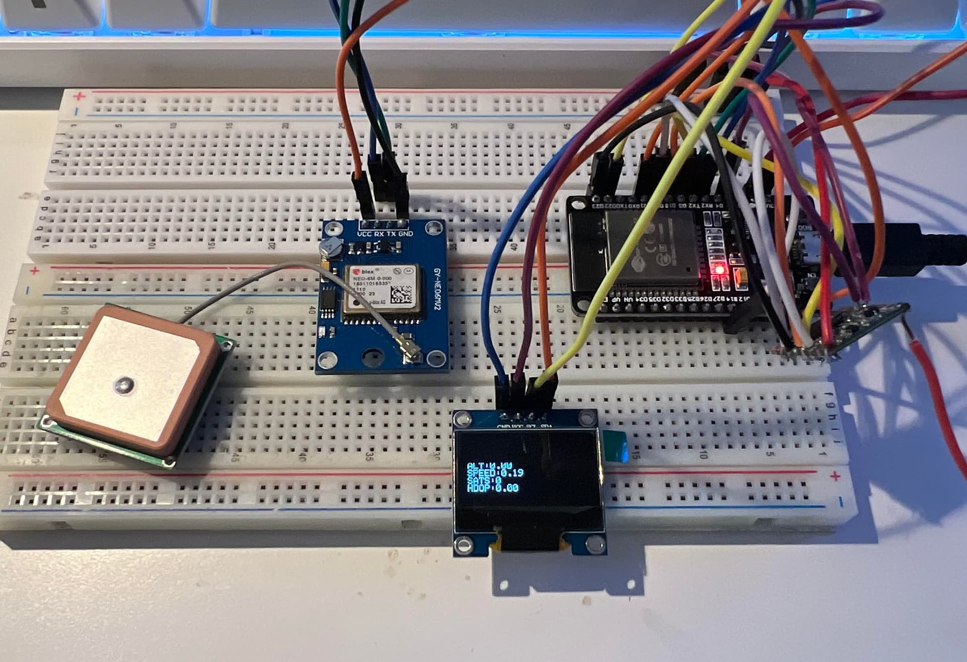

When the code (listed below) is uploaded to the board, everything works out perfectly. The (TX) is receiving incoming data from the NEO-6M GPS and the SSD1306 OLED Display is giving off the proper readings for the viewer to see. However; if you notice, the LoRa portion of the code that's listed near the bottom of the code is grayed out for a reason. Every time I activate this portion of code into the overall code and upload it to the board, I get a few problems. The altitude, number of satellites, and HDOP readings all get bumped down to zero as if they're not receiving any data. However the latitude, longitude, and speed are all reading correctly. I want to ensure that the incoming data will be retrieved correctly before sending it over to the (RX). If anyone has any helpful tips to fix this issue, that'd be great. Thank you for your time today and have a great day!

Here are pictures of the before and after from uploading the code. The latitude and longitude readings are blacked out for obvious reasons.
Before (Code w/ the LoRa Part Grayed Out):
After (Code w/ LoRa Part):
Software serial can cause problems when your using interfaces such as SPI for the LoRa device. Hardware serial ports are much more reliable.
Might not be you problem, but there is no reason at all I can see to risk using Software serial when the ESP32 has a spare hardware serial port.
I'll definitely have to do more research about this, but do you know what HardwareSerial enables a user to do? What's the benefit to it and should it resolve this error I'm facing? Thanks for your help!

How would you go about in fixing this code? I hate to ask, but I'm stumped at the moment. Thanks for your help in trying to solve this issue!
for a start use hardware serial ports
e.g. remove the statements
#include <SoftwareSerial>
SoftwareSerial gpsSerial(RXPin, TXPin);
change the Serial2 pins definition to and rewire your PCB to suit
#define RXD2 16
#define TXD2 17
do a globaal find for gpsSerial replacing it with Serial2
recompile and run - does it now work as expected?
if not report what it should be doing and what it is dong with associated serial monitor output (as text not screen image - add extra Serial.printf statements at key points to check program flow and variable values
I followed the advice you gave on switching to HardwareSerial along with fixing the commands for the ESP32 and it worked! The final test was to enable the LoRa.print commands near the bottom of the code and still be able to view the right readings without them reading "0.00" consistently on the (TX) SSD1306 OLED Display. I proceeded to test the (RX) and the data is being transmitted through successfully. Thank you so much for the advice as I really appreciate it!
