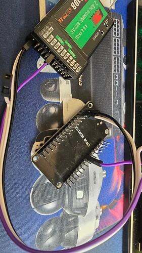

I use ESP32 and I cannot send telemetry data through FlySky FS-iA10B receiver. I tried with iBusBM and iBUSTelemetry libraries, but the remote does not receive anything. I tried with Arduino nano and it works without problem, but with ESP32 I can't get it to work.

I tried with the serial outputs, changing pins, but no response. Wiring is correct, still works with Arduino Nano

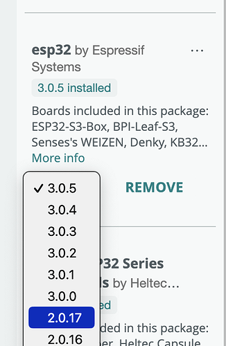

NEVER NEVER modify library code. Put the original lib code back then try this,
change the esp32 boards entry from 3.0.5 to 2.0.17, see pic
That Timer code is affected by the V3 migration, see the migration doc paying special attention to the Timer API at https://docs.espressif.com/projects/arduino-esp32/en/latest/migration_guides/2.x_to_3.0.html
I already gave you the APPROVED quick fix in an earlier reply, NEVER change library code.
It's already working
