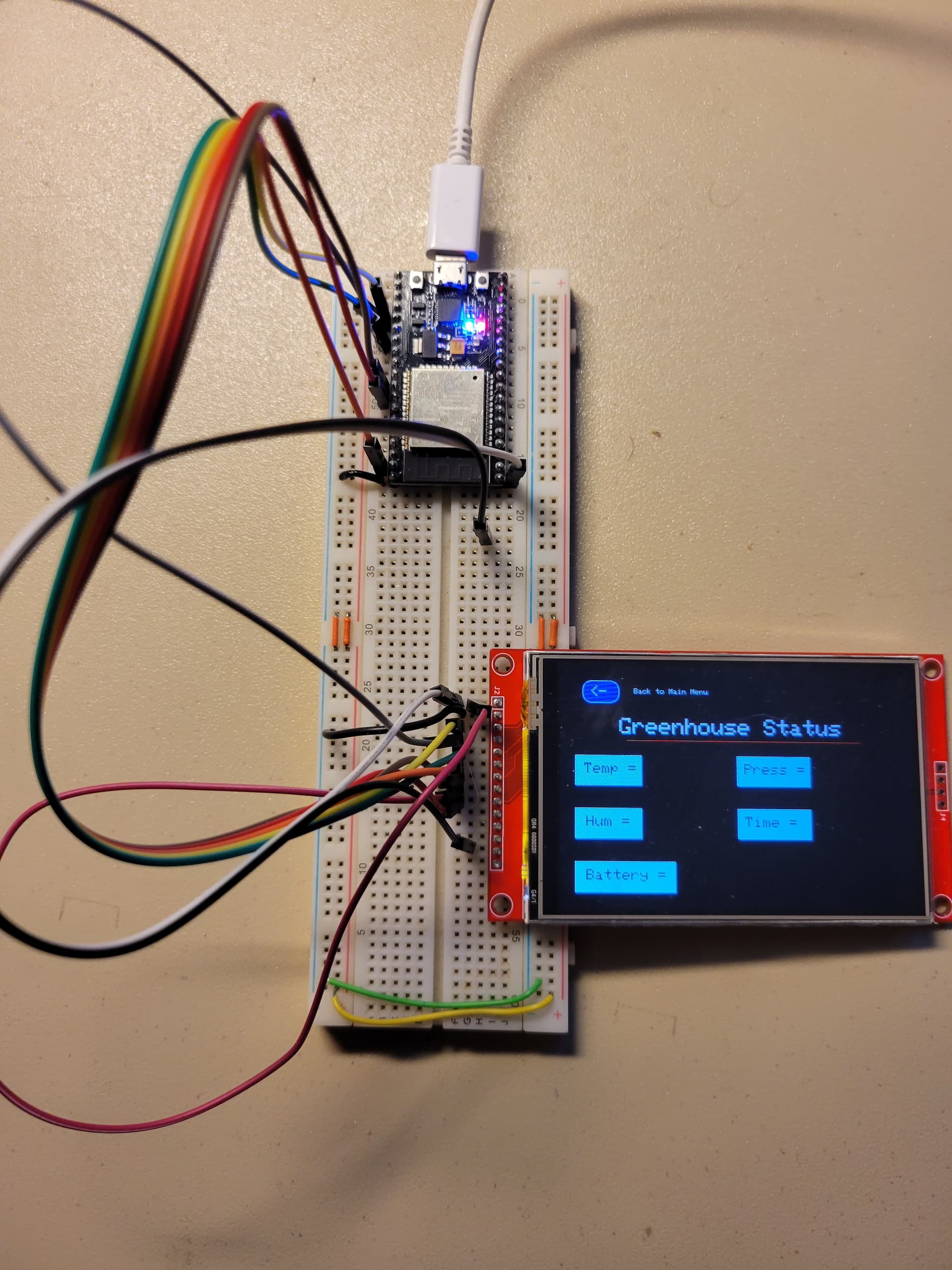

I'm trying to convert a project that I had using a Arduino Mega to a ESP32. I have a remote system in my greenhouse with a BME280 that was sending the values to the Mega via NTF24L01's and displayed on a TFT screen
I am new to ESP32's and also just started using the TFT_eSPI library to update the TFT. Currently I'm just trying to redraw the labels on the screen, not reading or displaying the BME values. I have the labels in a function block "drawGreenhouse1()". I call the function from setup. When I run it the screen blinks on and off. I believe it's doing a "tft.fillScreen(TFT_BLACK);" then my labels. If I comment out the function call and put the label logic in setup it works fine, shows the labels and it's not blinking.
I put a Serial.print("Start SetUp") at the beginning of setup, then uncommented the call to the function and commented out the draw labels in setup. What I see is that setup keeps restarting so I assume for some reason when I call the function it is resetting the ESP32.
I don't know why? Is that what's happening, it's resetting the ESP32 or is it something else?
Here is my sketch

Pin out connection of the tft?
You write the library?
@Idahowalker Here's the pinouts to the TFT
#define TFT_MISO 19
#define TFT_MOSI 23
#define TFT_SCLK 18
#define TFT_CS 15 // Chip select control pin
#define TFT_DC 2 // Data Command control pin
#define TFT_RST 4 // Reset pin (could connect to RST pin)
VCC and LED are to 3.3V pin on the ESP32 and Gnd to GND
and it's driver is
#define ILI9488_DRIVER
These are defined in the "User_Setup.h" file in the TFT_ESPI library. You have to uncomment lines to match your TFT. Here is the file as I have it set up

The code posted in post#1 does not contain the above information. Please post the code you are using.
Have you tied the backlight pin to VCC?
Post an image of your project all wired up and under power.

Here is a picture of the board and TFT, I've loaded the screen from the setup and commented out the call to the function, this is how it should look when called from the function but it appears to be resetting the ESP when I call the function.
Thanks for looking into this for me.

OK, the connections look good, the code produces a screen.
When you set tools core debug to debug does the ESP32 produce a printout when the thing goes wonky?
I'm guessing the vReg of the ESP32 does not have enough oomph to keep up with the tft needs. Try adding a 3.3V regulator off the 5V. Try adding a large electrolytic cap, 470uF, off the 3.3V line with a 103 ceramic.
I'll give that a try, won't be for a few hours I had some errands to run.
That would explain the resetting. If the 3.3v doesn't have enough power why does it work when I load the screen from setup as opposed to calling the function from setup?
Would connecting it to 5v make a difference? Should I use a separate power supply for the TFT? Maybe a different type of display.
