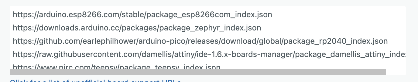

I am using IDE2 and have NO esp32 entry, they are included in the basic install. Here is my boards additional URL's.

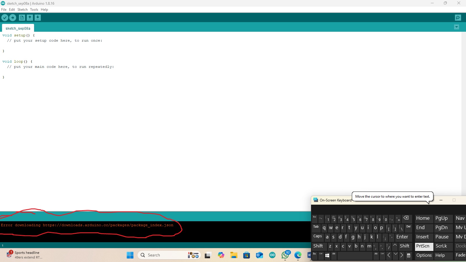

thanks for the feed back, this are the various error i recieved before putting the prefrence link and after puting. kindly look at them in this pics am unable to copy it
this same response i get for both IDE 1.8 and 2.0
Your screen shots show ide 1.8.16.

Error downloading https://raw.githubusercontent.com/espressif/arduino-esp32/gh-pages/package_esp32_index.json
 Error downloading https://github.com/espressif/arduino-esp32/releases/download/3.3.0/esp32-3.3.0.zip
java.lang.RuntimeException: java.lang.Exception: Error downloading https://github.com/espressif/arduino-esp32/releases/download/3.3.0/esp32-3.3.0.zip

this it
i use IDE 2 also same
Take a screen grab of your additional URL's and post here
[type or paste code here](https://raw.githubusercontent.com/espressif/arduino-esp32/gh-pages/package_esp32_index.json)
None of those are needed and may be causing your problem.
Use IDE2 to get things set up, then if you want you can switch to IDE 1 or run them both at once, I do that all the time as they happiy co-exist.

Still having same issue even with IDE2
The screenshot doesn't show the full error message. Please copy and paste the text from the "Output" panel at the bottom of the Arduino IDE window into a reply here on the forum topic.
Downloading packages
arduino:dfu-util@0.11.0-arduino5
esp32:esp-rv32@2411
Failed to install platform: 'esp32:esp32:3.3.0'.
Error: 2 UNKNOWN: Get "https://release-assets.githubusercontent.com/github-production-release-asset/66057540/164ae05b-81cc-4810-a343-f115f9482992?sp=r&sv=2018-11-09&sr=b&spr=https&se=2025-09-11T12%3A23%3A45Z&rscd=attachment%3B+filename%3Driscv32-esp-elf-14.2.0_20241119-x86_64-w64-mingw32.zip&rsct=application%2Foctet-stream&skoid=96c2d410-5711-43a1-aedd-ab1947aa7ab0&sktid=398a6654-997b-47e9-b12b-9515b896b4de&skt=2025-09-11T11%3A22%3A47Z&ske=2025-09-11T12%3A23%3A45Z&sks=b&skv=2018-11-09&sig=Vp%2BTNK7p5Fvp1zKjFM1S2G2dAu9IXwVMPC8J5iZgXwc%3D&jwt=eyJ0eXAiOiJKV1QiLCJhbGciOiJIUzI1NiJ9.eyJpc3MiOiJnaXRodWIuY29tIiwiYXVkIjoicmVsZWFzZS1hc3NldHMuZ2l0aHVidXNlcmNvbnRlbnQuY29tIiwia2V5Ijoia2V5MSIsImV4cCI6MTc1NzU5MDkwOSwibmJmIjoxNzU3NTkwNjA5LCJwYXRoIjoicmVsZWFzZWFzc2V0cHJvZHVjdGlvbi5ibG9iLmNvcmUud2luZG93cy5uZXQifQ.4iPFFCIkw3k9sB3aKOsh2zInxB6vcLTIr1nIXBz0uSw&response-content-disposition=attachment%3B%20filename%3Driscv32-esp-elf-14.2.0_20241119-x86_64-w64-mingw32.zip&response-content-type=application%2Foctet-stream": net/http: TLS handshake timeout
