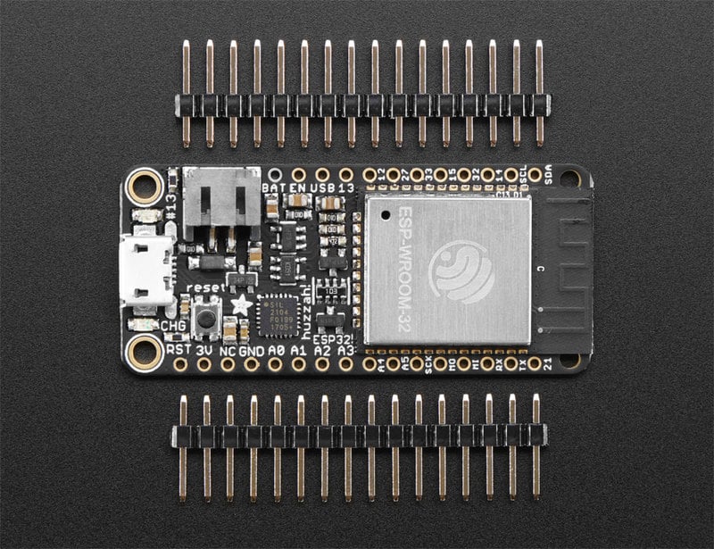

There are very few options for load-sharing chargers other than this one, or the MCP73831/2 which is built into several of Adafruit's Feather modules, like this one.
If you don't need many I/O pins, then consider using the XIAO ESP32C3.
Thumbnail-sized, built-in charger and LiPo battery connection.

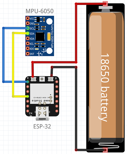

New schematic using Seed Studio XIAO ESP32 C3. Note the battery leads would be attached to the pads on the rear side of the module.
Comments?
CRAP! Forgot to power the MPU-6050! New schematic:
Updated wiring for battery powered XIAO ESP32C3. I corrected the SDA and SCL pins which were wired wrong in the previous schematic.
The main concern is does anyone see any issue powering this in the following manner:
  1. Directly from the battery as shown (wired to the battery pads on back of device).
  2. From USB 5v plugged into the ESP-32 USB-C port.
I understand that with USB-C (5v) plugged in the XIAO ESP32C3 will be powered AND charge the 18650 battery (load sharing).

" XIAO can be connected to your computer device via data cable while using the battery, rest assured that XIAO has a built-in circuit protection chip, which is safe."
I take that as "yes"... My intention was to use a typical phone charger "wall wart" as charger.
5V charger is ok as well.
Excellent! Thank you! Parts due in a couple days... will test and post results!
