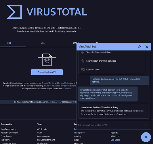

VIRUSTOTAL does nothing? : see screen shots.
I'm not sure what caused that. It works fine for me. Maybe you have a browser extension (e.g., an adblocker) installed that is breaking the functionality of the VirusTotal website? Or maybe it is our old friend "Intego Virus Barrier" interfering again?
Let's try going at it in another way. I'm going to ask you to attach the file to a reply here on the forum topic and then I'll upload the file to VirusTotal for you.
