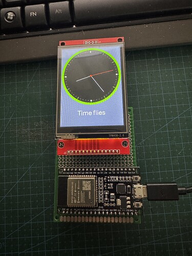

Esp32 and 2.8 inch espi display works fine but touch screen not working. I have tried all the settings I have found and impossible to make it.

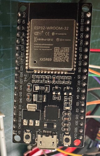

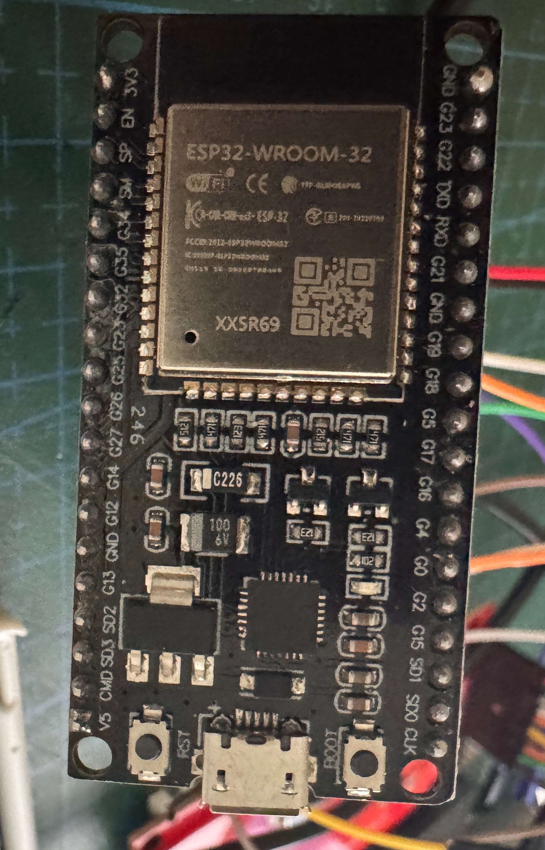

CS:15 RST:EN D/C:2 MOSI:13 SCK:14 LED:21 MISO:12 T_CLK:25
I have tried connect pins MOSI and T_DIN, MISO and T_Do , did not work.
User_Setup.h (19.0 KB)
No one bothered my question. So I helped myself and solved my problem. After deep searching I found that T_clk and SCK pins should be connected like MOSI AND MISO were connected to T_DIn and T_Do consecutively. Now the touch screen works fine.
