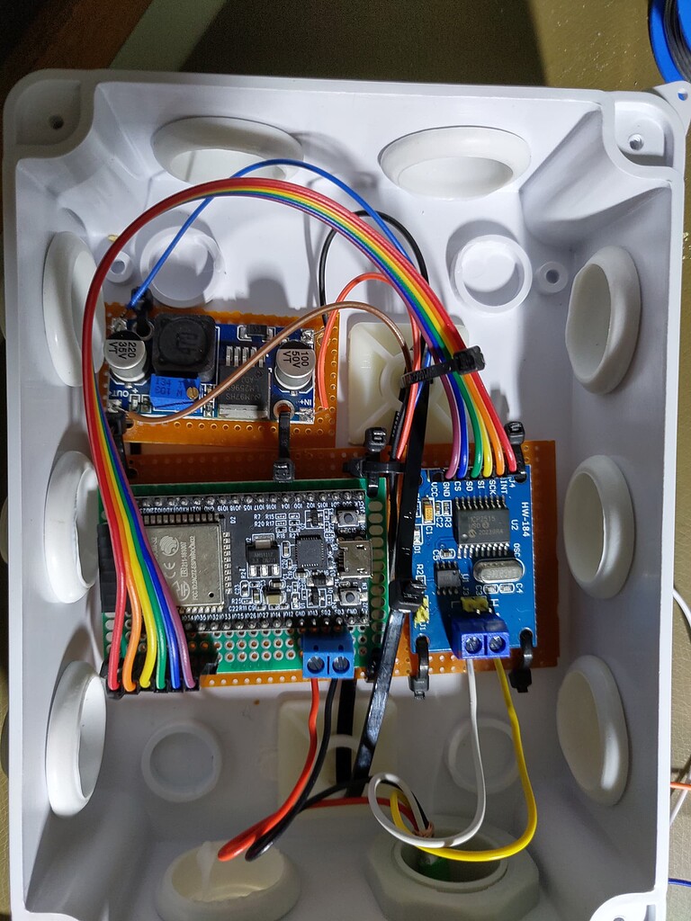

Hi I try to get your example running on an ESP32 using an ESP32-Wroom-32D board.

I know esphome does not need the INT pin but i connected it to pin 16 and used this example just modified to be sure serial monitor is working:

But I dont get any output.
The Can Adapter is the same mentioned at post 1.
Does any of you have an idea what is going wrong here?

How often is the ESP Home device sending data?
Is there some sort of heartbeat keep-alive mechanism that periodically sends a packet and expects a response?
Try a higher frequency such as 100kbps. From memory, there's a hard coded timeout limit in the library that needs to be modified when using very low speeds.
I do not have an ESP32 to test against, so I am afraid I am of no immediate help. I will monitor this thread though.
I have ~5 Messages per second on the bus. Its the can bus of a Stiebel Eltron Heat Pump that is working with 20kbps.
I also tried this example before:
but same problem. I dont receive anyting. If I flash esphome again without touching aything its working like a charm.
I dont understant what im doing wrong here :frowning:
According to a comment on this page, the pump only sends data when prompted by a query. If your code is only listening and nothing else is sending queries then the pump will remain silent.
There is still some traffic between the contoll unit and the display.
I saw that in the logic analyser.
But i found the reason for not working.
I used this example for wiring what worked with esphome:
After I removed the 4k7 resistor it also start working with the example postet above.
Dont know why but its working. So my problem is fixed :slight_smile:
