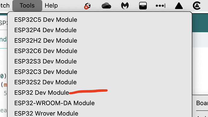

Looks like damaged flash. Can not be segment length like this
Just select a normal esp32 Dev module. Also show an entire cycle from boot to boot.

yes I ve tried both the ESP32 Dev Module and the ESP32 WROVER Module !!
I ve got 2 and I ve tried them both it's the same ! I don't know if they both damaged? (I ve just got them and it's the first use)

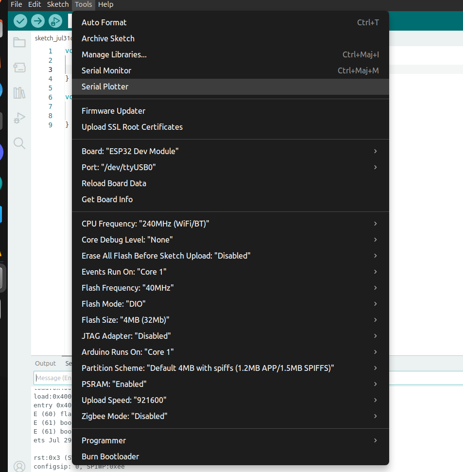

You have to play with Arduino IDE->Tools->Flash mode
Also, you have to select Arduino IDE->Tools->Partition scheme->Default 4MB With SPIFFS: this will fix you bad partition table.
As I said before - it is defenitely problems with FLASH: either hardware or, most likely, wrong setup.
Try to use DIO mode for flash. Try to lower frequency for the flash. Set default partichion scheme (a must now)
I did like you said here is the setup but it seems like nothing have changed!
but the message error has changed here is what I have now

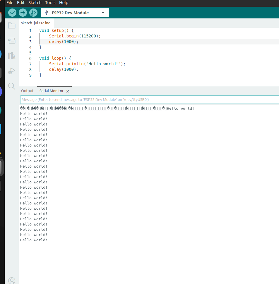

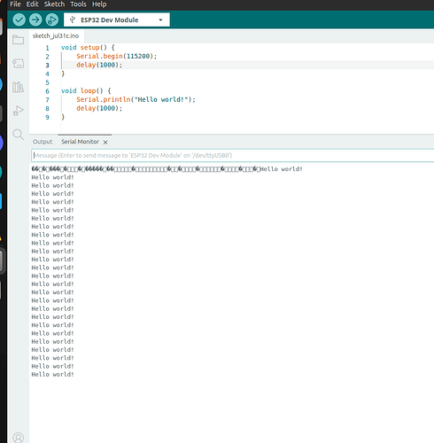

wait it s weird I did reupload it again and it actaully works
Thank you so much, It works now!

Yes, you changed the Tools menu back to what it should be. Unless you are 10000% sure you know what you are doing, it is best NOT to mess with that, no matter what you read on the internet. Many people plant false posts to mess you up; they are sick.
