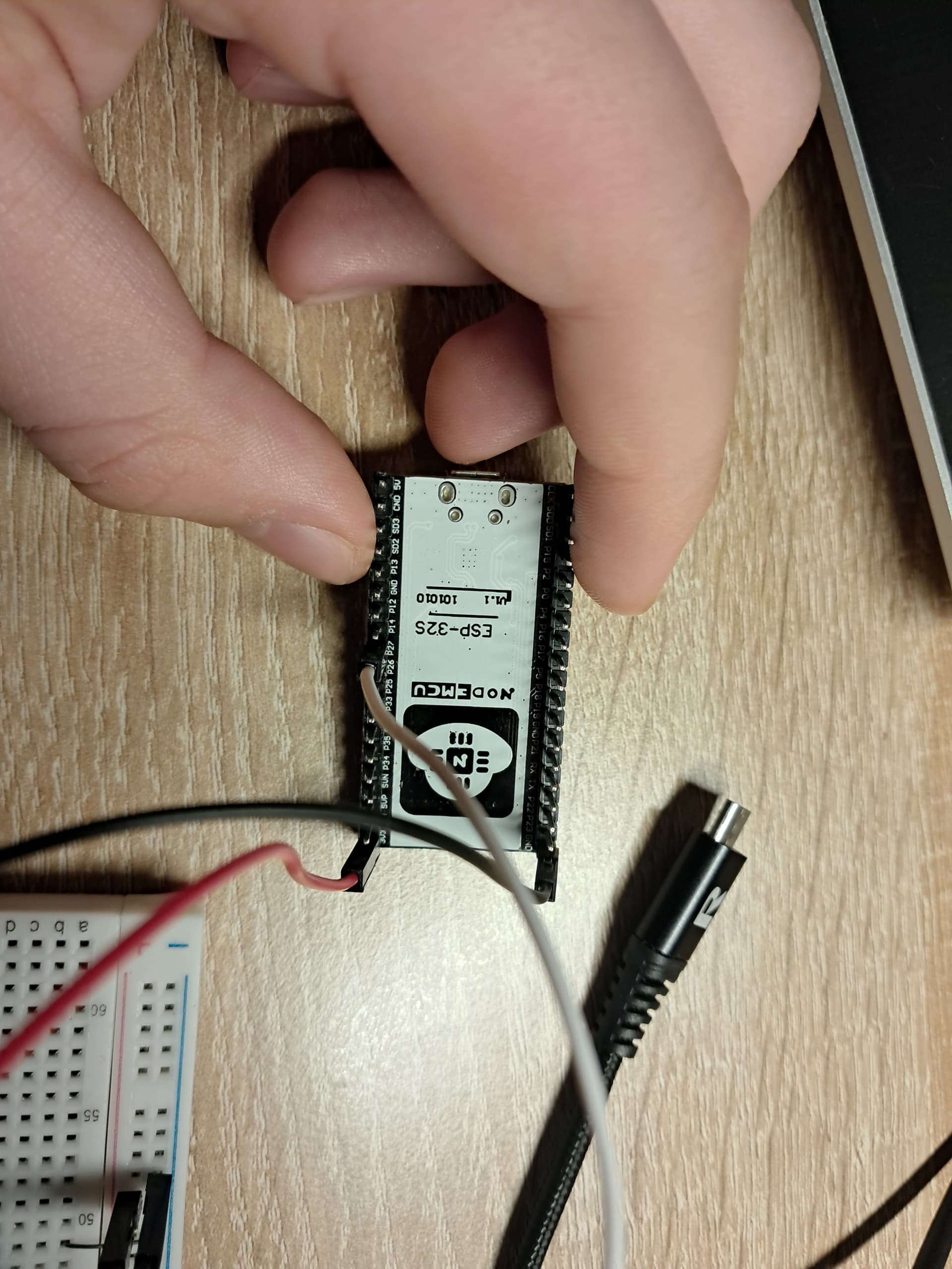

Hello, I am working on a weather station wibe project. It utilezes ESP-NOW that transmits data to the "server" (esp32) from sender (esp8266), then it displays on basic server interface that I can open in my browser.
Here are the specifikations
So the problem basicly is that the dht-11 sensor failes almost all the time and when it finaly works it displays humidity of like 140? Also on my web server it displays the board number one (esp32), but not the esp8266, which doesnt make any sense becouse for the function to be executed there must be incoming mesage from esp8266. The dht-11 sensor works just fine I tried changing them, but the problem lasts.
here is my esp32 (server) code

here is my esp8266(sender) code

Please post schematics. That sensor seldomly causes problems.
maybe worth having a look at DHT11 vs DHT22 – Which Temperature and Humidity Sensor Should You Use? and DHT11 vs DHT22 vs LM35 vs DS18B20 vs BME280 vs BMP180
here are the photos
I also tried the code from examples and the sensor works fabulosly.
if so what is the problem?
for temperature and humidity I tend to use the BME280
for temperature alone the DS18b20 in particular the waterproof version in rivers, water tanks, etc
You were requested to post schematics. Photos are useless.
sorry I dont know how to create one
I will definetly try thoes sensors but becouse the dht readings from the examples are fine and on the webserver they arent, I would say that the new sensors wouldnt help, but I am a beginer so I dont know.
You can get a great CAD (Computer Assisted Drawing) package for free. They will ask for a donation but that is not required.It is a complete package that will take you from schematic capture to a complete set of Gerbers to make a PCB.
Here is a link that will get you started: How to Read a Schematic - SparkFun Learn You will also find they are a great source for parts. This will take a few days to learn but well worth it. Frizzies will be a waste of time if you expect to advance.
You can use pen, paper and post a picture of the drawing.
here is my drawing of the schematic
(thoes thinks on the top are dht11 sensors)
