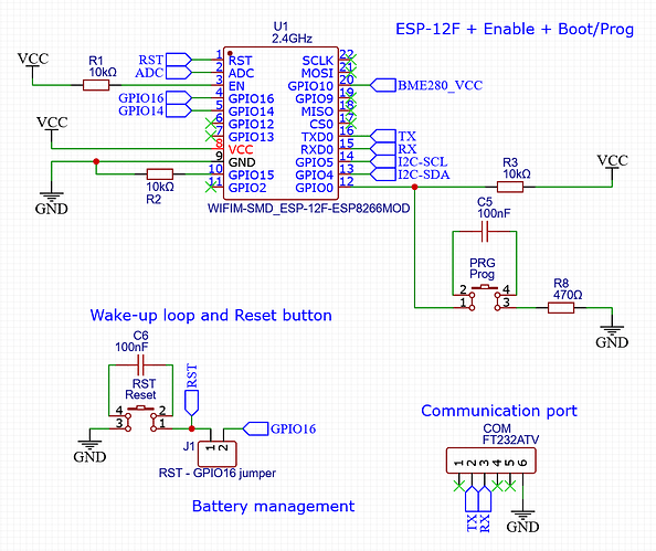

Here is how I wired ESP-12F's:

Check, new board with multimeter, maybe GPIO0 is connected to gnd?
Hello noobmastha,
Thanks for your reply!
With power off, I've been able to properly check these two resistors' measurements between GPIO0 and VCC for R3, and between GPIO0 and GND while pushing on PRG for R8.
I did not find any continuity between GPIO and GND. When checking the opposite (multimeter's COM on GPIO0 and Red touchpin on GND) I found a "diode-like" reading at 743mV. I can not explain this measurement with ESP-12F's internal circuitry.
With power on:
  • VCC is stable at 3.33V at all time.
  • I find a stable 3,3V between GPIO0 and GND and startup.
  • If I press Reset, it drops to 2.5V (!?).
  • If a press Reset again, it rises back at 3,3V (!!).
  • It will flip back and forth at each Reset pressing...
Working thermometers do not behave like this. GPIO0 is at VCC potential and have just a few tens mV drop when pressing Reset, probably beacause I did not add a pull-down resistor between RST and GND when pressing Reset button.
What do you think about this wiring?
Thanks a lot again!
Thomas
Well considering that GPIO 0 is within bounds (not pulled LOW) and GPIO 15 is pulled LOW as it should be, there are 2 more pins we need to check.
  • GPIO 2 looks like it isn't connected, but is there a LED connected to it ? How has that been connected ? a simple active LOW is fine of course, the LED & resistor pull it up, but maybe there is something else going on there. Can you add 10K pullup to the pin ?
  • GPIO 1 (TX) should also not be pulled LOW, and again maybe you can add a pullup there to see if that helps.
Still it is a bit strange, because all that really happens when waking up from deep sleep is that GPIO16 pulls RST LOW, and for the rest the boot procedure is normal.
I found something here where there is a bit more explanation of the second digit in the boot mode. If it is 2 (as in boot mode 3,2) that means that it is 'jumping Boot' i don't know why it does that, instead 3,0 (remapping) , and actually it seems that only the first digit is influenced by the GPIO states.
So i provided you with some more information, which unfortunately i don't think will help you much.
Maybe you should just order so other units from Ali (or a different source) i got some from here and those are fine, though i am not using them with deepsleep, so i can't help you with that or verify that that works as it should.
btw, shouldn't RST have a pullup resistor ?

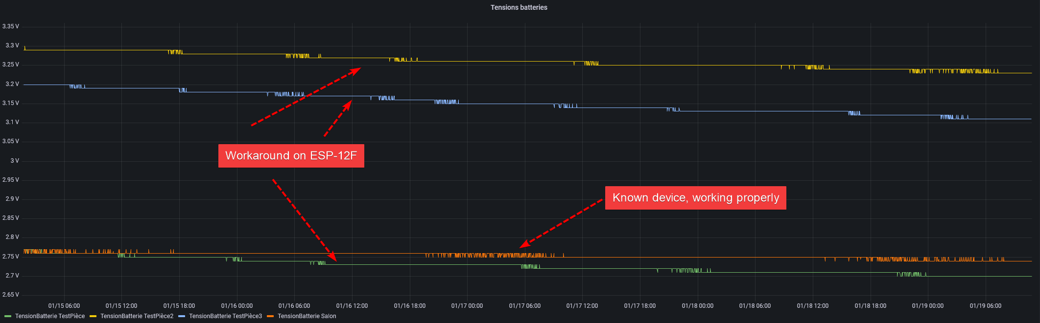

Dear all,
A week later, here is my first feedback testing the MISO workaround @d_ferdi highlighted.
It looks like the battery consumption is following the same slope that is known with properly working devices. Let's have a look in an additionnal week but it seems that it's working!
Thanks!
I think that it remains in boot mode because the RST is not connect to VCC through a 10k resistor. In the schema I do not see the connection to VCC that is important for normal mode.
