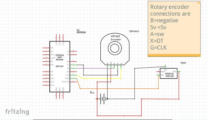

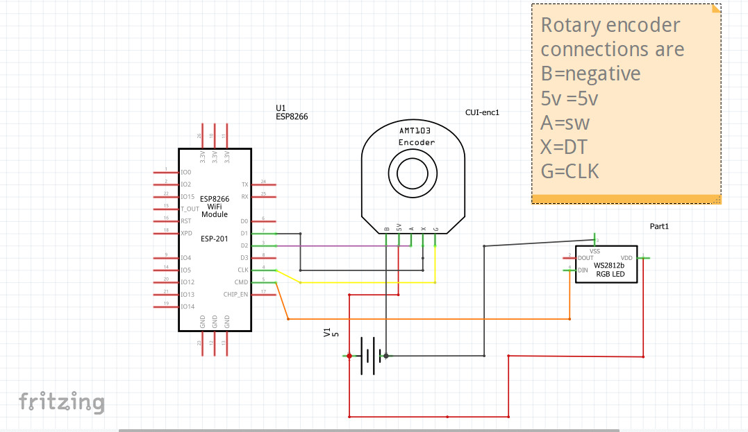

ESP8266+Rot Encoder results in Neopixel not displaying
Hi All
I recently purchased a Node MCU ESP8266 " NodeMCU board ESP8266 WiFi module CP2102 ESP-12E Lua WiFi [LB-LR0128]" from little Bird (in Aus) . If I program it with a blink sketch or similar it will drive 40 Neopixel etc. If however I load a sketch that includes a Rotary Encoder to add more control the Neopixel's will not light.I have changed the Rot Enc but it made no difference.I have included 2 Sketches below and neither of them will light the Neopixel`Any assistance would be appreciated
Cheers
Nick
SKETCH No1

SKETCH No2
Next

Why not clean up the post, you have the code pasted in then it follows uploaded properly. Also a schematic, not a frizzy picture would help.
I'll repost but I did use the code tags but something went wrong

Here is a diagram of the cct
GPIO14 = D5
GPIO4 = D2
GPIO12 = Pin A
GPIO 13 = Pin B
You seem to be sending 5V signals into a 3V3 processor!
The supply should have been indicated as 3.3v which is actually how it is connected. The supply to the ESP8266 is coming from USB
So anything else that is not true about your schematic, like that battery? Please post it again in a new post your schematic exactly how it is wired.
We can only work with accurate information.
