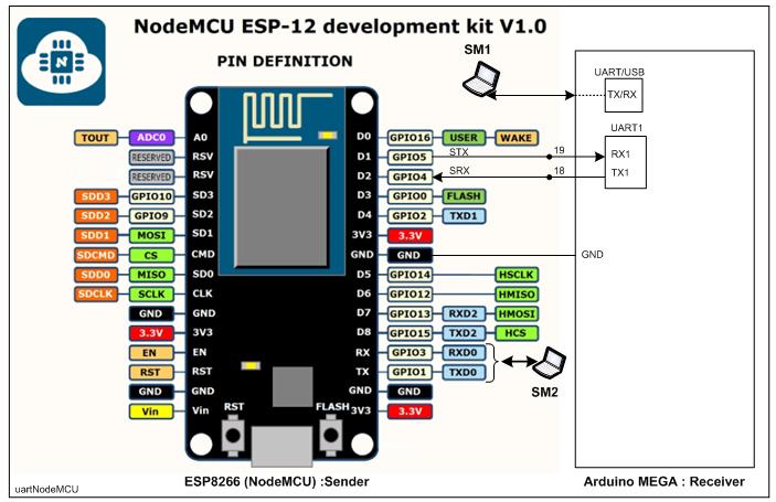

STEP1 SETUP
Current connection is as follows:
TX(ESP)->PIN2(MEGA)
RX(ESP)->PIN3(MEGA)
