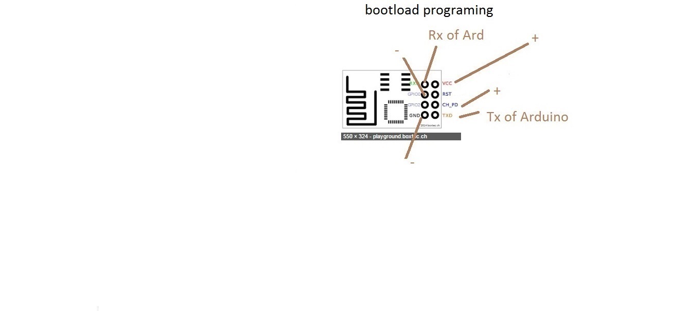

I used a connection .Can you check is it correct .
thanks.
No, as you didn't use a level converter. The ESP-01 runs on 3V3 while the Arduino (at least the usual ones, you didn't tell us which one you use) is at 5V.
