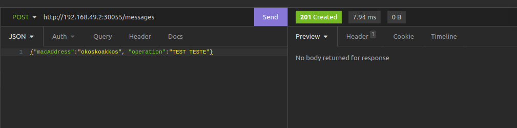

I am trying to do a POST request to my Webserver that is running in a Kubernetes cluster.
If I do this request in postman, works fine:
When I try to do this request trought ESP8266 it does not work. The status code response is always -1.
I opened a Ngrok tunnel to my web server to find out what is going on and found that the ESP8266 request didn't even touch the application.
