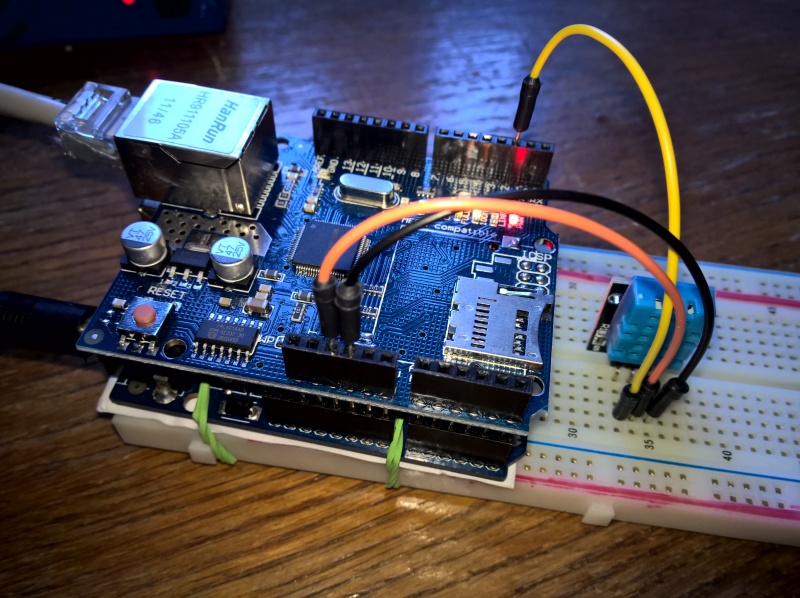

I am not so experienced with Arduino and I would like to get some feedback for what I did. Some parts of my project might be usefull for others.
I decided to create another version of ethernet enabled temperature sensor (based on DHT11) that logs temperature into a log file on a webserver througth HTTP GET request. There are many versions of this project on the internet like [1] and [2]. But in my version the only requirement is that PHP is running on the server, database is not needed.
I tried to use POST method for „uploading“ data to the server but I found some problems and I choosed rather to use GET. From some http documentation I understand it’s not that secure but I don‘t care.
Things started working well after writing full http request that was constructed by [3] inserting by string
yoursite.wz.cz/uploadDataVer2.php?temp=25&humid=50&id=area51

Full Arduino code:

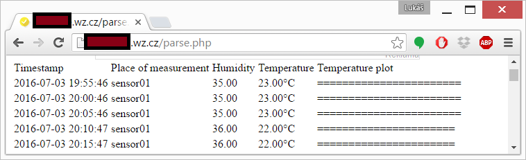

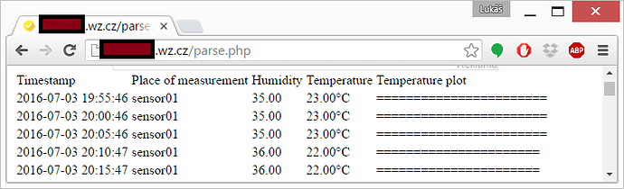

The server side:
There are 3 simple files:
uploadDataVer2.php that captures GET request and adds timestamp. The output of script can be readed througth serial connection.
clear.php that clears/erases the log temp.log
parse.php creates slightly formatted table with visualisation using bars by equal sign „=“
