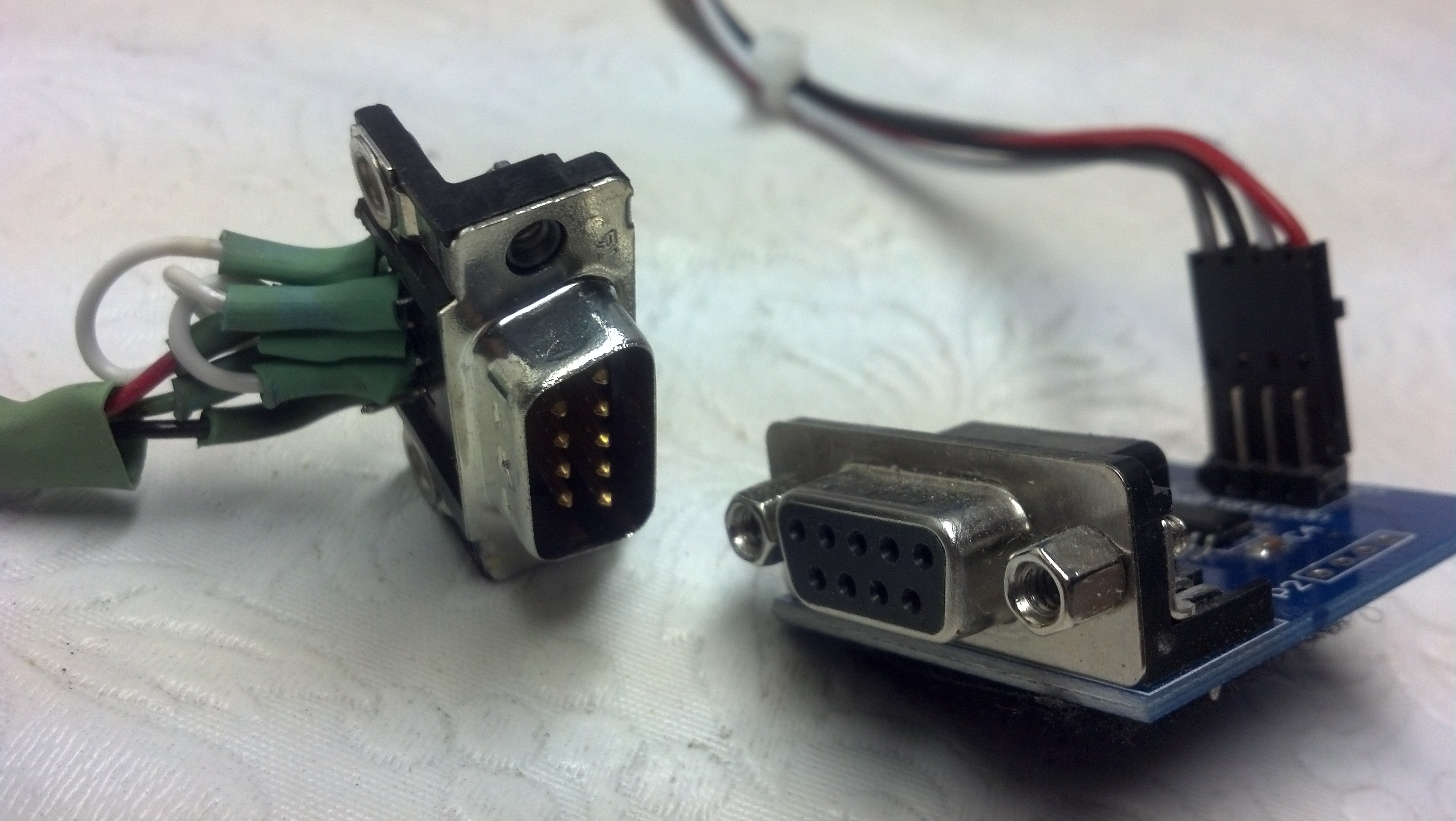

Let's take an older example, The DB-9 SERIAL CABLE.
If you look at the "Male" connector , meaning the one with MALE pins and look at how it plugs ONTO the "Female" DB9, meaning
the one with FEMALE pins , you will see that the FEMALE Connector (as we are defining it for this discussion) is actually a MALE
housing because it plugs INTO the FEMALE housing that has the MALE pins. (sounds confusing but a picture is worth a thousand words) see attached
RJ connectors and housings are integrated and don't separate so the female pins are the springy looking things that the male pins push against when you plug the LAN cable into the jack. So as far as RJ connectors are concerned , the male pin is part of the male housing and vice versa ,.DB connector pins are usually integrated as well but Molex for example are removable. An RJ male is male housing with male pins and vice versa, unlike the DB connectors. Is everything clear as mud now ?

Thanks for that. No the picture makes complete sense to me however I cannot see why they wouldn't make a single housing that male both male and female pin terminals would click into, if you used long pins they extend out and the connector thus becomes a male, if you use short pin terminals with rounded ends that don't extend out of the housing it therefore becomes a female connector.
Seems logical to me but obviously not to dupont.
Thanks for clearing that up, I will make sure for my male to female 40 pin I require I not only buy both male and female pin terminals but that I also buy male and female housings also.
Rasch, you are now guilty of posting pictures whose excessive "resolution" way exceeds their focus.

but female pins are useful for the NRF24L01s, the RS232 to TTL converters (like the one in the photo with great resulution XD -that's my 8 Mpixel Android cell phone camera)
and the ICSP connectors on UNOs.
