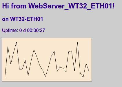

Debug Terminal Output Samples
1. AdvancedWebServer on ESP32_DEV with ETH_PHY_LAN8720
The following are debug terminal output and screen shot when running example AdvancedWebServer on ESP32_DEV with ETH_PHY_LAN8720 (WT32_ETH01)
Starting AdvancedWebServer on ESP32_DEV with ETH_PHY_LAN8720
WebServer_WT32_ETH01 v1.1.0
ETH Started
ETH Connected
ETH MAC: A8:03:2A:A1:61:73, IPv4: 192.168.2.127, FULL_DUPLEX, 100Mbps
HTTP EthernetWebServer is @ IP : 192.168.2.127
