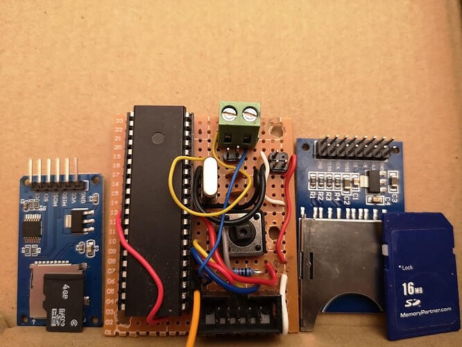

I have been upgrading "Single Chip Basic Computer" from HackaDay.io over 4 years and this time I'm adding SD-card. Original one never got TVout and SD working at same time. I have external mcu for graphics over serial so that issue should be solved. This project is deeply based on those files from HackaDay so I'm using ArduinoIDE1.0.5 and USBasp. Bootloader is "Mighty 1284p 16Mhz"
I think my 1284p is exceptional, cause every pin I ever set to anything is wrong. Same files, same circuit, same hardware.. different pins. And it's always two less. I always managed to set these right until SD.
When I ask what pins are SS, MISO, MOSI, SCK I get: 10,11,12,13.
But when I set 10 high, instead PB2 is high. That's physically two pins away and so are next pin's too.
Card is 4Gb micro-SD formatted to Fat32 with program shared in these forums. I use micro SD-card adapter from ebay that has on-board logic level shifter and voltage regulator. I did check the voltage and after regulation it's 3.2v, regulated from 4.9v. I also did try other SD-adapter that had resistors instead level shifter.

can you post a photo of your 1284p dev board?
do you have a pin mapping between the MCU io pins and the pins of the board? if not, create one.

This is small part of the whole system. Yes it's ugly as it's made from corpses of previous boards. Also those SD-adapters and cards I have. 16Mb card is Fat16

I see the picture now. It would be enough to mention that it is a not a dev board but your build on a perfboard, so no traces to board's pins. If I had such a build, I would make pins_arduino.h with a MCU physical pin mapping to port/bit.
the SD library should use the SPI library, which should use pins defined in board variant .h file.
I have a 1284p dev board which is not defined in AVR or MightyCore boards package. I use it with Arduino AVR package, but I have it defined in my hardware folder in pins_arduino.h

Solved, description in first message. I thank for your support. MightyCore is nice. Next I buy new soldering iron and try to feed old code for the new IDE as it really hate's PROGMEM parts of the code.
