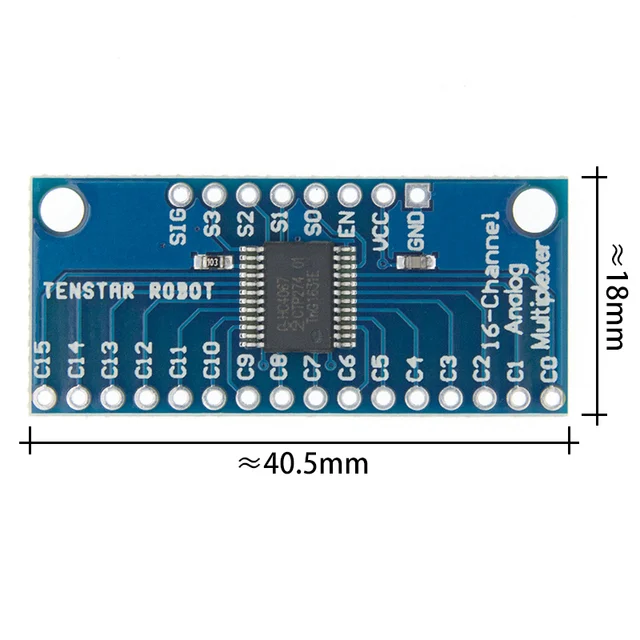

So, for what ive been seeing online im thinking in using an arduino pro micro, but if im correct it doesnt have all the inputs i need. To expand these inputs ive seen videos of people using a CD74HC4067 multiplexar (in some videos this component looked like this and in others looked like this). My two main doubts at the moment are: there is any diference between those or its just aestheticly different? Am i gonna be able to play all the 16 buttons simultaneously for example, or this multiplexar only gives me the option to play one note (button) at the time.

You don't need a multiplexer. Organise your buttons into a matrix. A 6x4 matrix will allow you up to 24 buttons using 10 pins. If it is important to be able to allow more than one button to be pressed at the same time, a small diode will need to be placed in series with each button.

Untrue.
