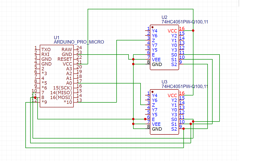

Hello, i am trying to make a midi Device with Pro Micro. It has more than 16 analog potentiometers and buttons.
To expand the I/O pins in Arduino i am using 74HC4051 Mux. But there are limited to 8 Inputs. So i decided to use 2 or more off them. My question is how to connect them, i know they must be on same SO-S1-S2 and different Z pins. A10, A0. I have stuck in code section. Here is my code for now.

Where are you setting MUX_COM?

That code works perfectly. Both multiplexer works great but some of the Inputs on second Mux transmit in same value with the first.
Ex. when i turn a Pot in first Mux i got Values in Traktor :
Mux1--Ch01.CC.018
WHen i turn a pot in Mux 2 i got the same Value
Mux2--Ch01.CC.018
Some of them transimit same CC, not all of them
And i get to much noise when no pot is moving this maybe cause the wrong note.

What value of potentiometer are you using? If it is 100k or more you may have to give extra time for the sample/hold capacitor in the A/D converter to change value.
If your inputs are not yet connected, of course your floating inputs are going to float! Don't use analog inputs that are not connected to a voltage source.

I am using 10K potentiometer and all empty input on Mux i have grounded with resistors.

Sounds like there is a mistake in some part of the sketch that you did not show. If you would like assistance in finding the mistake, please post the entire sketch.

The code looks correct so my guess would be a wiring problem like a bad connection. Put a multimeter on each of the 15 (Why not 16?) multiplexer input pins and make sure each goes from 0V to 5V as you turn the corresponding pot.
I test it with multimeter and a got this values from 0-4.5V on all pots.
Maybe as you sad its a lose wire on breadboard. I will put together in a pcb and see if it makes a difference.
