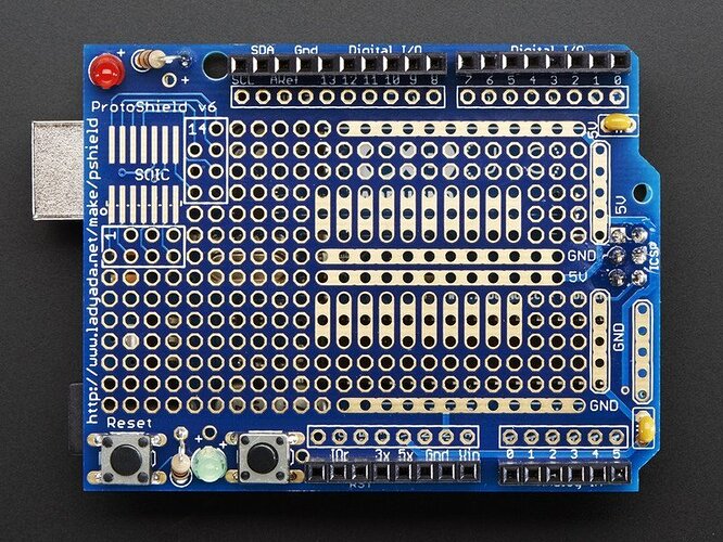

How can I use the extra button (not the reset button) and LEDs on this expansion board (see image)? I have searched for some example code but I couldn't find anything.
You don't need to look hard the arduino has examples for how to use buttons and leds. Start with the basics.
Just change the code to use the pins your led is on and your buttons. You can then add more as you see how this works.
Button
Turns on and off a light emitting diode(LED) connected to digital
pin 13, when pressing a pushbutton attached to pin 2.
The circuit:
* LED attached from pin 13 to ground
* pushbutton attached to pin 2 from +5V
* 10K resistor attached to pin 2 from ground
* Note: on most Arduinos there is already an LED on the board
attached to pin 13.

@Bups76
BTW
I took three single female headers and soldered them in the holes so wires can be plugged in just as you do on the proto board
@LarryD, thanks a lot. You made me understand how to use the LEDs and switch.
There a little more learning I think you better know that the switch needs a resistor or use built in pull ups because if you hooked it to a input It's not going to read right. Or if you mistakenly hook it to 5 volts it's will be a short when pressed.
On a double sided board like that, you can follow the traces.
aarg:
How can I do this? "Follow the traces"
It's not that easy some are small go under writing and come out somewhere else you have to learn how to see where the go and how to use a dvm meter to make sure your right.
You'd be better off learning to read and look for the documentation and the schematic first so you see how it looks and then try to find the traces. https://learn.adafruit.com/downloads/pdf/adafruit-proto-shield-arduino.pdf
