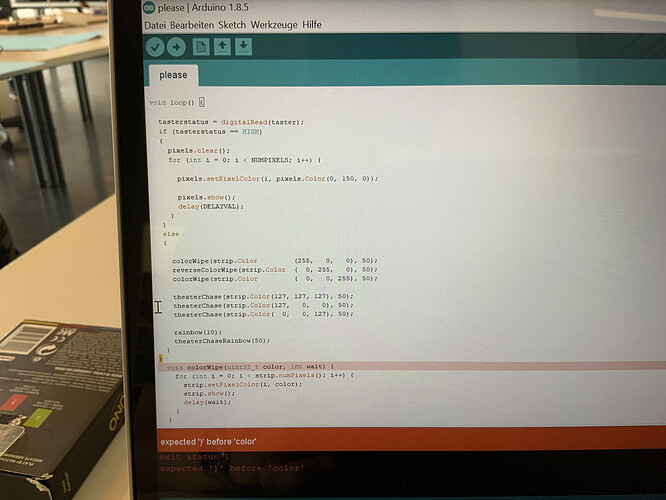

Ok, i placed void at the beginning of the line but still the error message “expected primary-expression before ‘void’ ” appears, because it doesn’t appear at the color wipe line but at the bottom at ‘void theaterChaseRainbow’
Btw I really appreciate you all trying to help me and i try you’r suggestions every time just as it is described by you but it doesn’t work.
This is what you told me to do, right? @cherk

I just pasted your code and this still appears…
I’ll just stick to my old code without the “taster” because everything is the SAME except the part between ‘else’ and the ‘void loop’
It’s literally the only thing i changed and it just keeps spamming me with error messages.

But not with the code you posted otherwise the functions would all end where they should with a }
