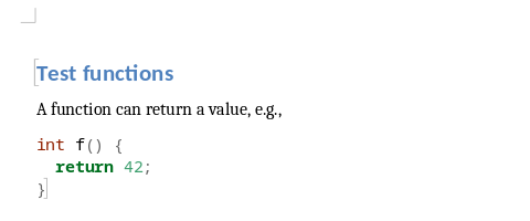

My advice would be to write the documentation in LaTeX, reStructuredText or Markdown and use something like pandoc to convert this to PDF or Word.
Example:
# Test functions
A function can return a value, e.g.,
```cpp
int f() {
  return 42;
Convert with:
pandoc -o test.docx test.md
Output:
screenshot
Please find the input and output examples attached: test.zip (9.0 KB)
