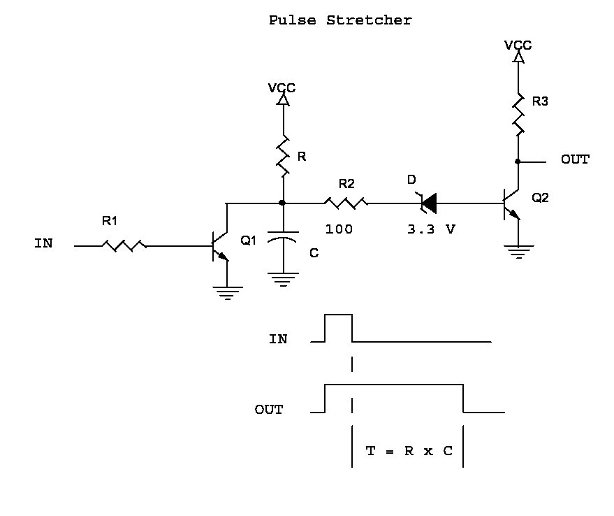

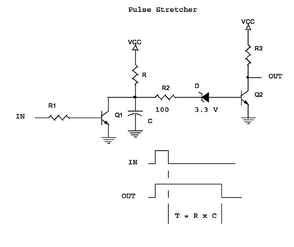

I shall then.....I amplify the signal, clean it and extend the pulse, which gets fed into the IC... yup i'll have a think about it and design a circuit,

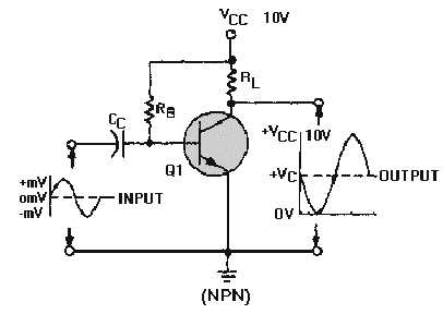

First stage amplifies the tiny signal from the ir detector, this gets amplified via the transistor attached image 1.
Second stage (providing a square wave is applied) and some extra (maybe) components to filter it, then lastly extending the pulse.
Pretty straight forward by the looks of it…
Moderator edit: Non-technical comment removed, (Nick Gammon)
What you attached here is a lot different than what you posted about

How is the “photodiode” supposed to interface with the AC amp you’ve attached?
I think that you ought to be able to explain your proposals beyond, “right, well here’s a copy&paste of something or other; so make sure you get it all right, simple.”
