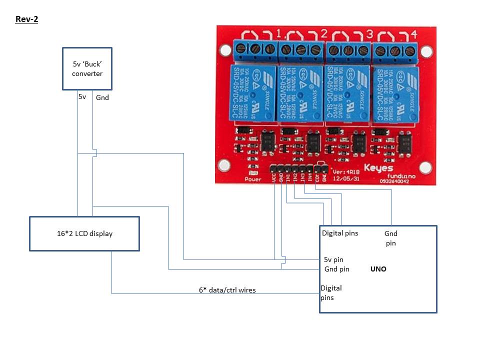

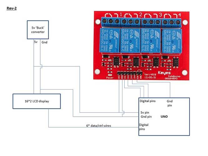

Does that sketch (Rev-2) matches what you mean?

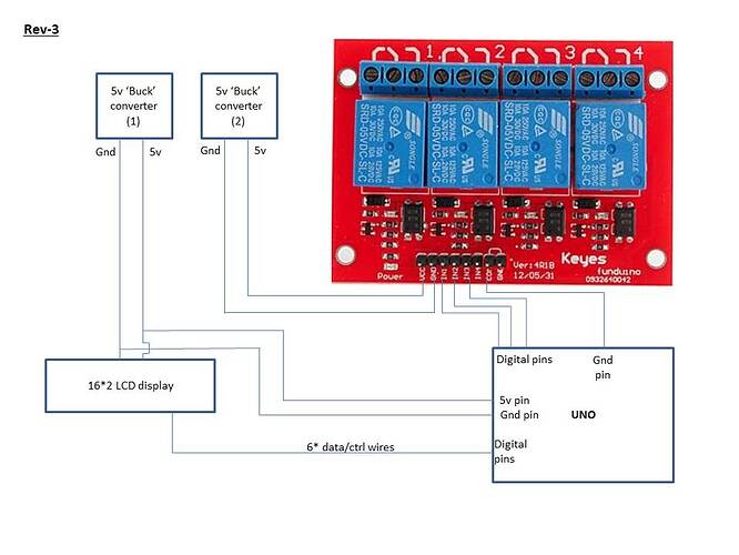

Due my actual design, and in order to refrain from long power-supply wire, I am thinking of adding another 5v-buck, and connect it to supply only the power of the relay-module - this is in the sketch in Rev-3.
Will that give me the confidence to avoid inductance/capacitance issues?

No, "Revision 2" is not what I described at all. You have the power wires branching off at random points.
What I said was that given you have one buck converter, the pair of power wires from the Arduino go - together - to that buck converter while the the pair of power wires from the relay module (you have those correctly connected now at the relay module) go - together - to the output terminals of that same buck converter where there will be a decoupling capacitor which will minimise the transmission of surges from one device to the other.

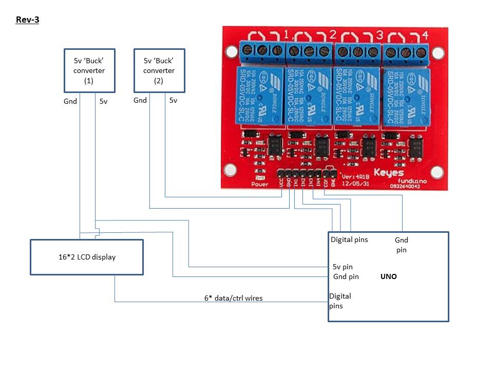

Your "Revision 3" shows this arrangement correctly but you would be just as well to use just one buck converter for a start.
An improvement would be to put a 470 µF capacitor directly across the relay power terminals of the relay board itself.
Finally, the same discipline should be applied to the LCD. Its power wires should come from the Arduino together with the data/ control wires.

Considering I am using 2 buck converters - would Rev-4 fit the requirements?
If the same power supply is powering both buck converters your GNDs will probably ‘not’ be isolated from each other.

Given that you get the wiring right, why would you want to use two buck converters? If there is any doubt about their ability to handle surges, then adding a capacitor as I described should cover that.
There is no "magic" in regard to isolation. The problems commonly described here in relation to switching transients from the devices switched by the relays interfering with the operation of the microcontroller result from only three effects; surges on supply lines due to effective internal resistance of the supply and lack of decoupling capacitance, inductive coupling due to open loops in wiring, and capacitive coupling due to proximity of control and switched circuits.
Proper design procedure manages all three as demonstrated by the considerable number of devices in commercial production which use relays entirely effectively.
