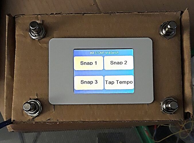

I've built a simple 4 button MIDI foot controller to use with my HX Stomp with a Nextion 2.8" basic screen as graphic "scribble strip", no functionality needed from the touch screen.
This is functioning and communicates between Arduino Mega and HX.
I have 4 pages (for now) in the Nextion Editor and all I want to do is trigger the Nextion page changes from the momentary switches via Arduino. I may add more to correspond with double click and long press.
You might ask why I don't just send text and colour changes from the Arduino, well, I thought this might be simpler!Maybe it isn't...
Your advice / help is most welcome.
I have attached page 1, the text should just change on the other pages according to button pressed
