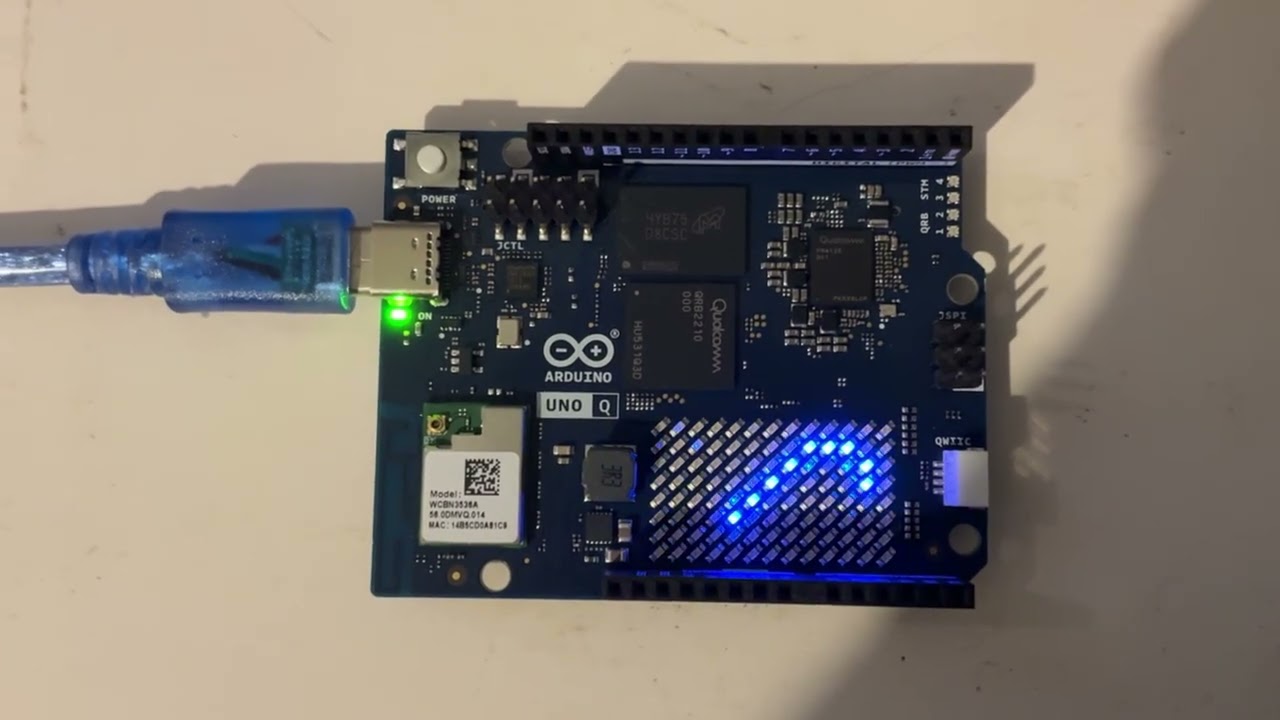

Got my Arduino Q this PM. I had previously set up the permissions asked of me. When I open the Arduino App lab it can't find my connected Arduino Q.
I am using a Mac by the way.
Sometimes the Arduino shows a pulsing heart, but I have also seen it trace out the Arduino "infinity" trade mark like a snake.
Any one know what to try now?

This is a video of the figure of eight / Arduino logo. This seems to appear when you change the port the UNO Q is plugged into on the USB hub of my iMac. Ig you leave it alone for a short time, like 3 minutes it will revert to the common pulsing heart. I don't know if this means anything though. I have tried pressing the reset button and even double clicking it, but it makes no difference.
