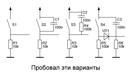

and a normally-on button connected in this way
So, when I press button signal on D2 is LOW. When i release it, signal goes to HIGH. I checked with oscilloscope.
What do i need: call FALLING interrupt on D2 pin (int0) when i presss button.
What i actually have: interrupt is calling twice: when i push button and when i release it. (working same as CHANGE interrupt).
But! RISING interrupt works as it should, so button connection is right.
What is wrong with my button?
Thanks.

You have switch bounce creating a second falling interrupt when you release the button. Google the term switch bounce or contact bounce. Here's a link to one of the best articles on switch bounce

I tried these (3 left schemes), they didnt help. Im 99% shure that its controller's fault
On your original code you use input_pullup but you also have a pull-down resistor? Why?
That is bad copy/paste
