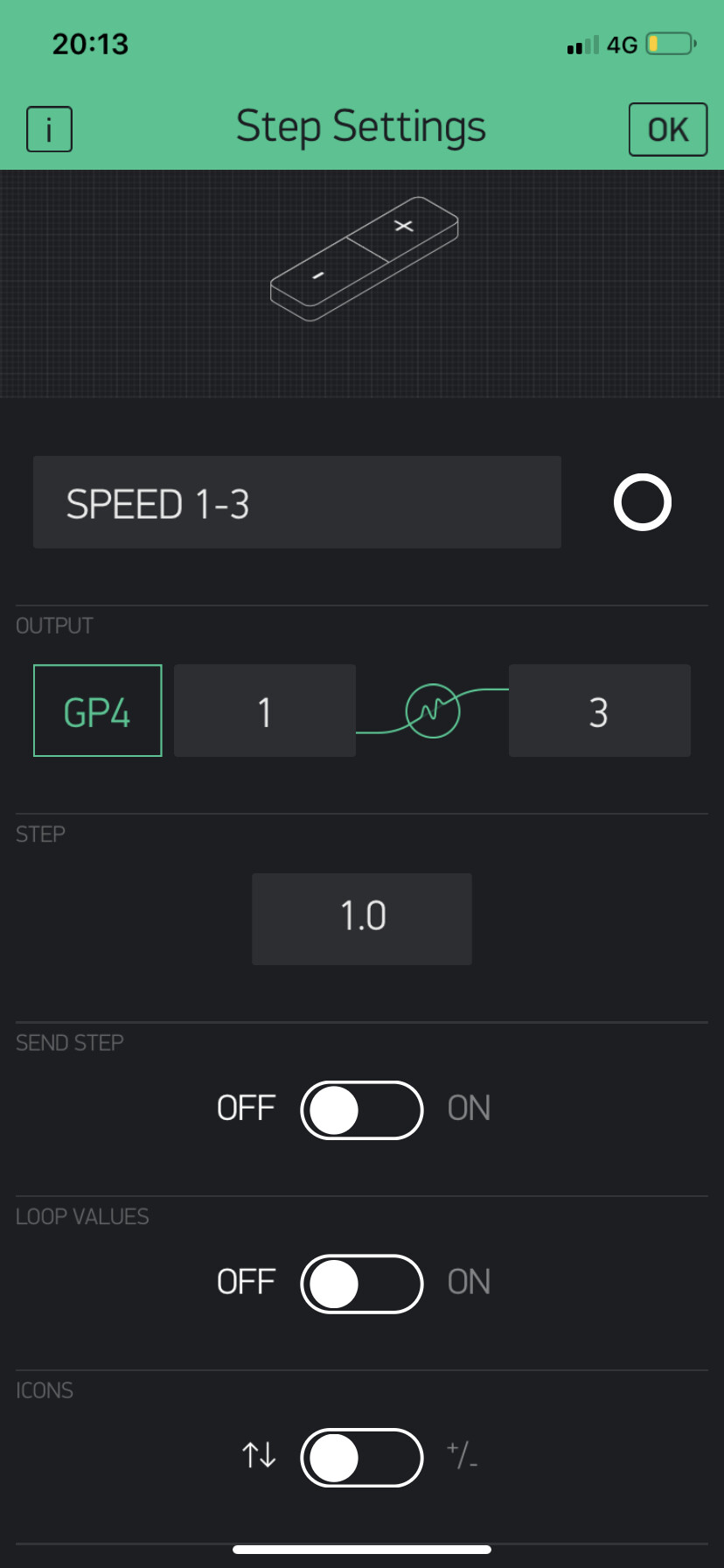

As the ESP8266 only works with 3.3V and my relays need 5V I switched the setup to LEDs. (already ordered a XL6009 DC-DC Booster and an ESP32 - as i´ll need more Outputs)
Just read the info-box of Blynk regarding my so thought "pushButton" and its not. its a step control.
It says that its like 2 buttons assigned to 1 pin. One button increments the value by desired step and another one decrements it. I assume that changes everything.

Edit: I should have said from the beginning that I´m not working with a fisical button.
All commands are send from ESP8266 by Blynk-App.
I assigned the App 3 steps 1-3 in 1.0 steps.
I can also activate a loop to be able to switch 1 - 2 - 3 - 1 - 2 - 3 - 1 - 2 - 3 & so on.
or block it, so i can only switch 1 - 2 - 3 - 2 - 1 - 2 - 3 - 2 - 1.
All that (i think) plays a big roll on the actual sketch.

and this is the blynk setup i have for the Step Settings

here are some further explanations on the Step Settings

I can't work out from what you've presented exactly what Blynk is doing, but assuming it sends a something like a LOW to change the speed and a HIGH when reseting, even if this is in a character string, say some command is sent to change speed, so when no command, no change... this can essentially be distilled down to a boolean. The rest of the implementation is fairly strightforward...
const byte relay[4] = {5,6,7,8};// 4 pins for relays...
// relay[0] can be the on-off relay so we will index through 1-3:
const int onState = HIGH;// these are here just to swap if your wiring is opposite
const int offState = LOW;// e.g. using a mosfet to drive the relay coil because of port current or voltage or to isolate the coils to mitigate differential mode noise from the relays...
byte relayIndex = 1;// declared as global and set to the default speed of 1
  // all the stuff in setup
  for (byte i = 0; i < 4; i++) {// we setup all relays in the array, including the on off...
    pinMode(relay[i], OUTPUT);
    digitalWrite(relay[i],(i == relayIndex) ? onState : offState);// all off except default speed...
//elsewhere in code... you have successfully received the Blynk command and call the following function.
void changeSpeed() {
  (relayIndex >= 3) ? relayIndex = 1 : relayIndex++;// change the index number
  for (byte i = 1; i < 4; i++) {// notice we start at 1 and go to 3 same list minus on/off
    digitalWrite(relay[i],(i == relayIndex) ? onState : offState);// all off except current speed...
