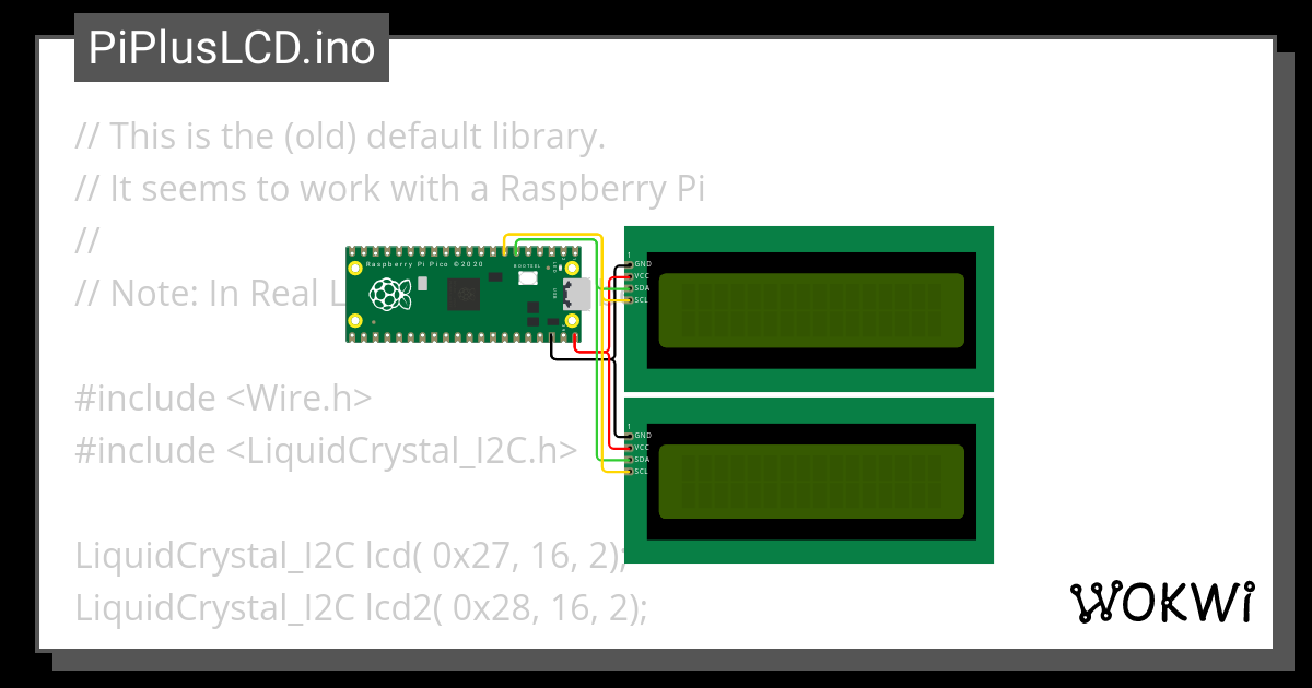

I made a Wokwi project for you:
The Wokwi simulator has also a simulated Logic Analyzer.

thank you Koepel, I appreciate your support !
I have tested your sketch, but with one screen only. It works, but I am not sure to understand its interest ?
I can however see that the library LiquidCrystal_I2C provides roughly the same time for one loop : 1ms for the first line only => equivalent to my sketch/LCD_I2C.
