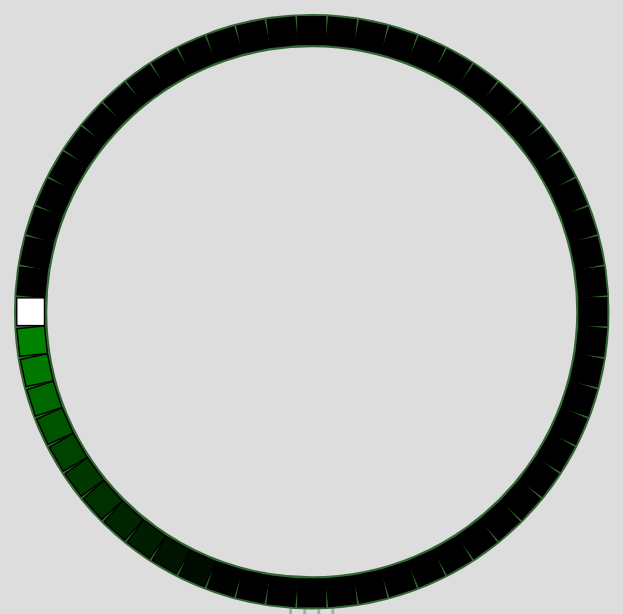

Helloo all help if anyone can ?? i am making a strip been at it a few days now, love the fadetoblackby effect got it going and all ok but need to adjust its start and stop point then move on to another part of code, used Neo pixel also but just pulling my hair out trying to sort it.
need to have clear strip set of 6 white led move to a set pint with a tail and fade at the end.
set point to be statci diffrent colourdlights then wite trail to move on again to final set of red lights.
attached both codes one is fast led just test the other is the main game.
any help would be fantastic.
cheers
Rob

  fadeToBlackBy(leds, NUM_LEDS, 4);      // Smaller value = longer tail
  int i = (millis()/40) % NUM_LEDS;      // How fast it goes.
  leds[i] = CRGB::White;
  FastLED.show();
code for neo pixel works just want the white line to be a trail not a static strip fill.

The first sketch works nicely.
The second sketch only gets this far...
... but it has so much inside (colors, fades, chases that are unused).
I made the first sketch do this...
if you load that code it will run now trying to get the white to be a few leds with a faded tail behind it, rather than a solid line.
Cheers in advance for any help

I think if i can just alter the start and end point a few times of the fastLED code and get the orange and red sections to flash a few times ill be there.
Any idea how i can set a start led and end led position that is not the full lengh of the strip?
my micky mouse version ...
for(int i=40; i<strip.numPixels() -43; i++) { // For each pixel in strip...
i edit the "i=40" bit then the "-43;"
void colorWipeDEMO(uint32_t color, int wait) {
    strip.setPixelColor(i, color);         //  Set pixel's color (in RAM)
    strip.show();                          //  Update strip to match
    delay(wait=30);                        //  Pause for a moment
That is what sketch #1 is doing... are you trying to do something different?
yes thats correct if i could take the first code with the tail behind it and replace this code solid white tail you would have cracked it, but one code is neopixel and the other is fastLED,its my firs time coding as you can probably tell...
to add extra fun all activates on a button press but i think i am ok with that bit.

Okay. You want to use Neopixel?
FastLED already has the "fade to black" but you can make your own... something like this...
Move your 100% neopixel. The next neopiixel is 75%. The next 50%. The last 25%.
Color first Neopixel (at N+0) 100% color.

And... here is a simulation showing FastLED showing a "fire" pattern
