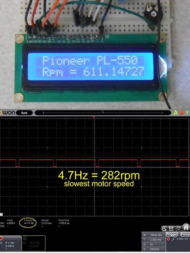

Thank you for commenting. I tried your sketch, only modified for my standard 16x2 lcd. I slowed down my motor as slow as possible. As far as the sketch, while I see how your isr calls start and end time with FALLING criteria, I am unclear on the rpm calculation theory, i.e., taking the inverse of calc_time multiplied by 60. I also find that the rpm value is pretty unstable, sometimes values changing dramatically . Please see my attached photo for the rpm measured by my oscilloscope trace and the lcd display...still pretty far off. Ideas? btw, before powering the fan, I can move the rotor back and forth with my fingers and the white stripe passing in front of the IR sensor and it has no problem picking that up.
Checking the reading from the scope it should be 283 rpm. So your calculation it is right. What I do in my program it is go to the interrupt routine wait until the pulse arrive read the start time, wait for the second pulse read the time and calculate the rpm. Can you print to the monitor the calculate time before the rpm calculatio9n.? Serial.println( calc_time,DEC);

Thanks for all your comments. I hope I answer all your questions. I have found that the "best" position for the sensor is about 1"=1.5" away from the fan blades. Your sensor is a bit different than mine(see attached), although apparently yours also goes low when it detects something in from of the IR.The fan has 7 blades, all black and my white tape, while not reflective in the true sense, is also 1/4" wide. I'm not fully knowledgeable on flags and some of the tricks in your sketch, so I'm a bit confused. But, in looking at my sketch, where I am incrementing rev++ in the isr, if I am counting the FALLING signals due to the interrupt on the exact same wire where I have my scope probe attached, over a delay(1000) which when you subtract millis()-old_time is 1002, or so, then the scope and interrupt D2, or D3(I also tried another pin), then Arduino rev and scope Hz should be the same over the period of 1 second. But, it's not. I wish I had a metronome. I'll try some very slow "flicking" back and forth and time that.

  2. Then, when placing a .04mfd disc capacitor across the output pin of the IR sensor and ground the lcd display, i.e., Arduino #1 interrupts and Hz counter immediately very closely matched the oscilloscope. Interestingly, that capacitor has no influence on the scope display at all. I'm a little puzzled as to why the influence on Arduino interrupts when the scope display show very sharp and well-defined waveform with FALLING characteristics. But happy that it is resolved.
Thank you very much for your suggestion.
Congratulation that you was able to make it worked. I came with the same conclusion. The capacitor does not do anything to the signal. What I think it does is provide more power to the Arduino UNO pin. In my original project I used the Mouser Photologic® Reflective Object Sensor OPB760, Buffered Totem-Pole. It is a TTL output and no problem with it. It is very clean.
