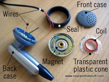

Going as far as your link takes me without trying harder, it looks like the experiment in the paper involved very small exciters, an array of 24 to fit on a person's forearm.
Much smaller transducers… would need much less power. I'm thinking like old fashioned earbud speakers, a coil and a magnet and a diaphragm.
But you said a large surface. Are you nevertheless still talking about a device for humans to receive numbers and letters through vibrational patterns sensed by a forearm?
Or?

You are completely correct that the exciters are smaller than the one linked.. Some on that page are smaller, but the one later shown in the picture is much bigger. The correct one is this one.
yes. I considered the forearm to be a large surface :astonished:

I mentioned the ear bud "speaker", it seems like a better match in terms of size and my current apprehension of the desired outcome.
a7
Yes, i also considered the earpieces speakers ... the possible problem is that they have a really light and thin membrane, compared with the mass of the rest of the speaker, so is probably difficult to "feel" the vibration (after all, using them we feel almost no vibration in ear, sound apart) ... maybe glueing some plastic in the center of the coil for make it weight more ...
