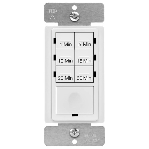

Or you can use this
If I used that, I wouldn't have the spirit of an inventor, would I? Reread my initial post.
