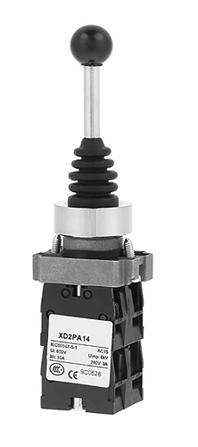

Step 1. Move the momentary spring-return 12vdc joystick lever to allow power into the Arduino V3 Nano.

This is the joystick:

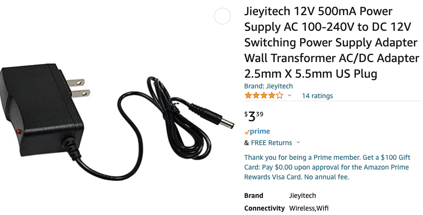

This is the 12VDC 500ma Power Transformer:

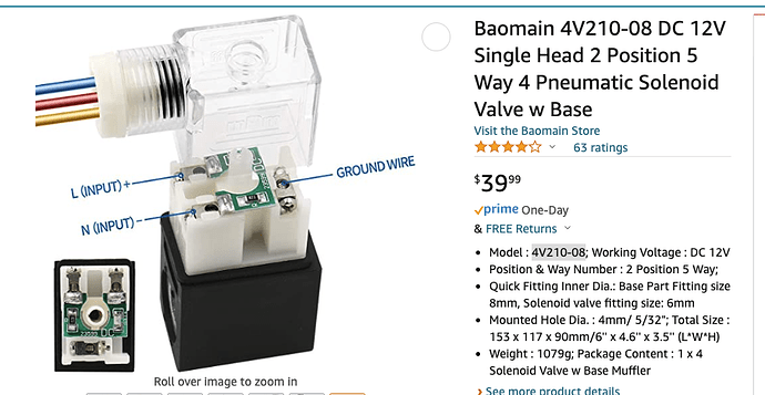

This is the Pneumatic Solenoid. It takes 12VDC 300ma to activate it. I tested it with a toggle switch and it works just fine. Just need to control the activation sequence and duration.

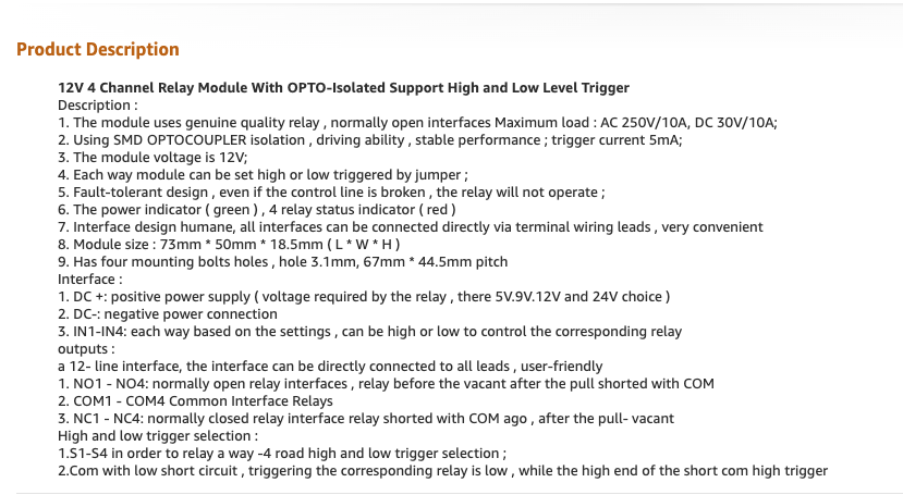

Ordered this 12v 4 channel relay module from Amazon to drive the solenoids:

You have a 12VDC 500mA power supply and 12VDC 300mA pneumatic solenoids, with at least 2 solenoids working at the same time, which means you need a more powerful power supply.
And 12V is pretty much to feed your arduino.
7-9V will give you more max. current.
Even better would be a separate 5V supply directly connected to the 5V pin.

I see. I do have stronger transformers and will check the specs right now. Be right back

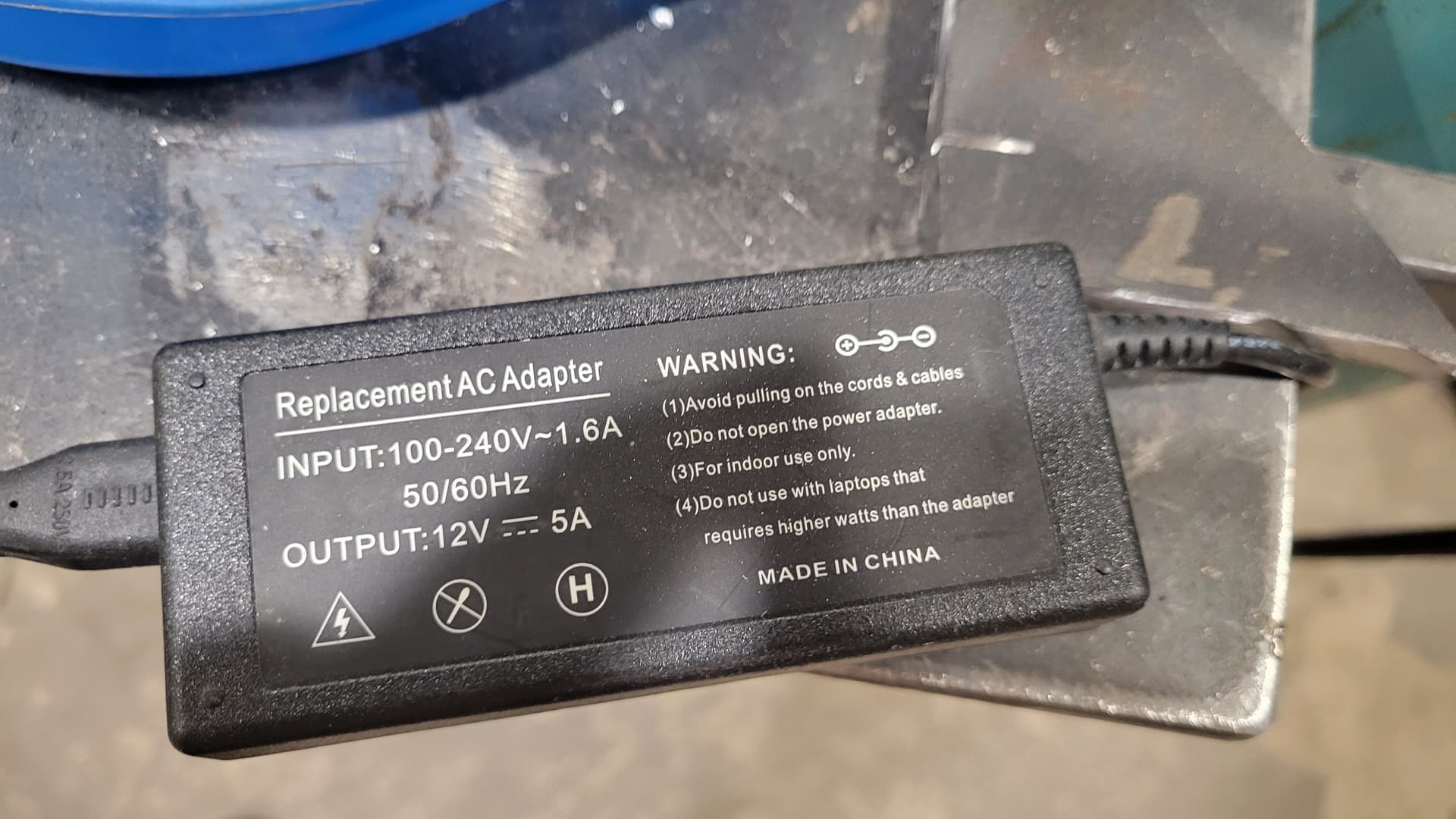

I have a 12v 5amp transformer. Will this work? Will I need to code the electrical output or do it with resistors?
You will need a good 12V supply for your relay board and solenoids.
If your nano isnt handling much current you COULD also power it from the 12V, or use a converter like this to give you 5V.
My advice - test 1 stage at a time; check the relays are working before you connect the solenoids.
