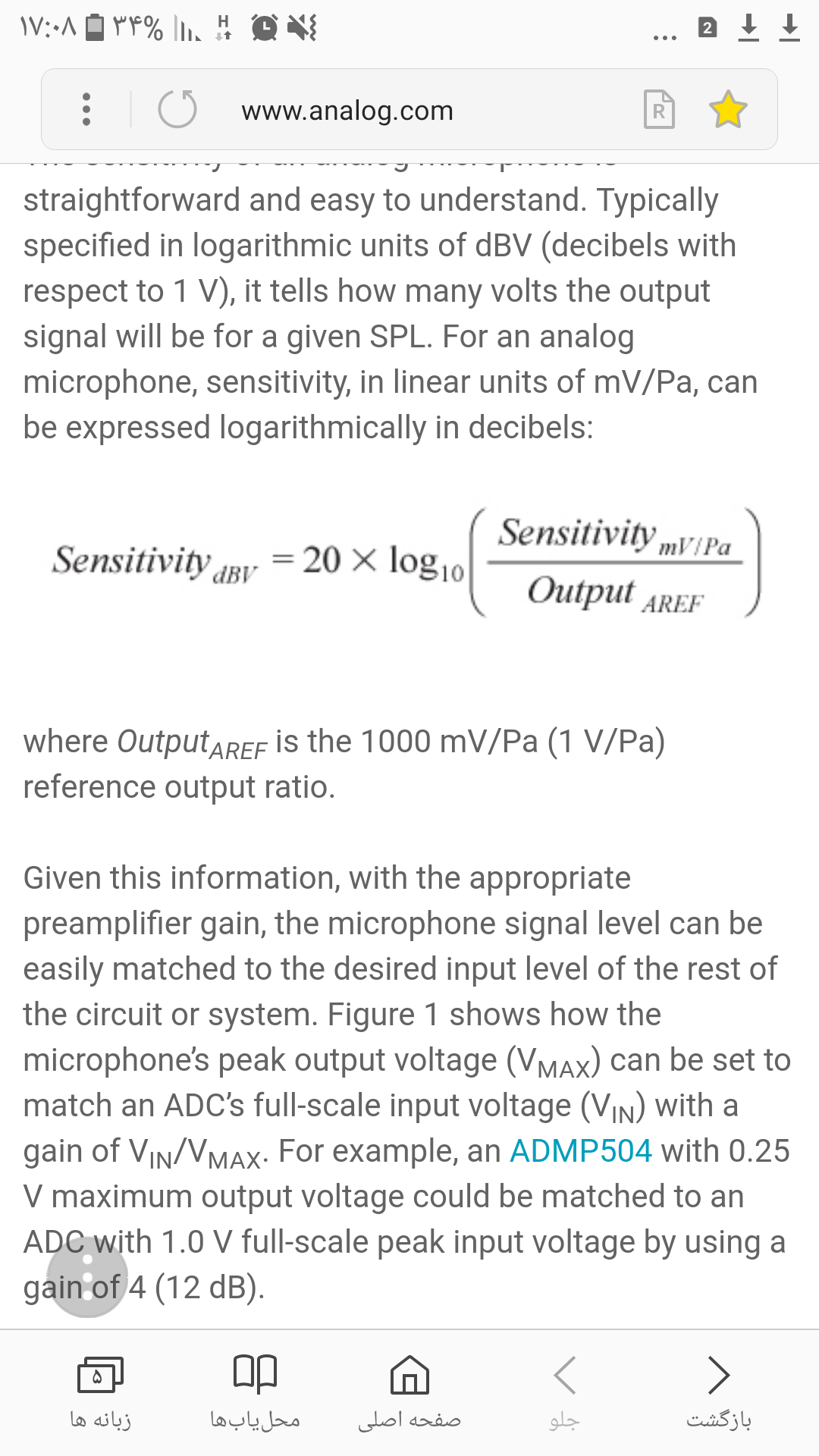

I want to make a sound level meter that show result in dB A_weighting For get a weighing must first analyze sound and then wighted There are a equiption that convert adc to Vrms and then dB dB =20log(Vrms/0.0063)+94-sensivity mic-gain If i can Vrms in per bin .i can calculate dB per bin and then i can weight them and calculate overall SPl in dBA

0.0063 get from sensivity of microphone
If mic sensivity be -44dBV the by under equiption you can calculated
In that case, why do you add those other two terms? Keep in mind that 20 log(x/y) = 10 log(x²) - 20 log(y).
