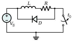

My main question is, aside from capacitor filtering, do I need to add diodes anywhere? I was thinking to put a diode on the power and ground lines, so current can only flow in on the pos cable, and out on the neg cable. This would block out the voltage spikes from the solenoids, as well as any AC voltage off the MSD box, correct?

If the relays and solenoids are electronically switched, they MUST have protective diodes backwards across the coils to protect the switching circuit. If you are worried about signal noise and that induced 30Vac, put .1uF and 30-50uF caps in paralell across your power buss (positive feeds to ground) in as many points as you can, particularly a set close to the arduino power feed. That will take care of switching transients and the induced ac. The closer that you can get the .1uF caps to the switching sources, the better.

Diodes aren't filters. You can turn them into rectifiers if your voltage ever goes negative (you'd have bigger issues at this point).I'd say get some big caps and filter the DC. The bigger the better they'll eat a ton of junk.
Big caps will take care of the slow stuff, but you need small ones to take care of the fast spikes too.

I was going to use the diodes to clean out the AC signal that's present in the system. Then capacitors will clean up the DC enough for the voltage regulators not to fluctuate?
If you have an AC component of 10V-pp and a DC offset of say 20V. You're going to get a sine wave that goes 15-25V. A diode won't clean that up since voltage never reverses. Rectifier - Wikipedia
If they're introducing an AC component enough to bring your total voltage negative, that's not good.

I thought that by nature, AC voltage takes the negative lead pos and positive lead neg? Or is that what you mean by negative voltage?
magnethead794:
Say you have a perfect 20V DC voltage. Then you start getting leakage from the ignition system. Say that's 2sin(ft). So now your signal is
20+2sin(ft).
Say you're doing this in a work shop with some overhead florescent lights, you're going to get some noise from the line voltage in the walls at .1sin(2pi60t), then there is noise from random other sources. Eventually you'll get a "full" fourier decomposition of the signal.
20+2sin(ft)+.1sin(2pi60t)+.01sin(1000t)+....
The NET signal is still positive so the diodes won't do anything other than make sure the signal flows in one direction. This is where the lowpass filter comes in.
