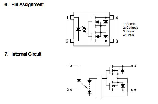

I intend on controlling a 24v solenoid valve via a photocoupled mosfet tlp241a
The maximum power of the coil will be 20w (hopefully 10-15w when all is said and done)
Now because the solenoid is an inductive load i believe ill need a snubber.
I was origonally thinking a 1n5404 diode. Would this be sufficient? Or overkill?
Or am i better to look at a capacitor and resistor combo?
Or something else.
Im looking for a reliable, cheap and simple solution.
Thanks in advance to all who reply!

Is a flyback diode really needed with this device? It has 2 mosfets and 2 diodes.
A flyback diode across a solenoid shorts the kickback when the transistor turns OFF.
Without a diode, the collector drain would see many times the supply voltage of the solenoid.
Leo..
Did you look at the device the OP is using?
And yes I know what a flyback diode does and that is why I raised the question.
I don't see what difference an opto fet makes.
If you switch a solenoid with a common N-channel fet with integrated body diode, you still need a diode across the solenoid. Because that diode is in the wrong place.
Leo..
The 2 Diodes in the optocoupler are for static protection, they won't work as kickback suppressors.

justone:
I don't think you are seeing what function the flyback is doing. It's sole purpose is to mitigate the high transient spikes when the field in that solenoid collapses. Without it, the drain is going to see those spikes, and the body diodes are not meant to handle that. Sure , it might handle a few, maybe a hundred spikes before it gets damaged. You are simply asking it to do something it wasn't designed to do. That's where the big beefy flyback diode comes in
Say pin3 is solenoid supply negative, and the solenoid is connected between supply positive and pin4.
When the opto fet is "ON", current flows through the top fet and the bottom body diode.
When the fet turns off, the solenoid produces a higher voltage on pin4.
The top fet is exposed to a higher voltage. Both body diodes do nothing.
Leo..
Isn't the device a common source which means it can do DC or AC which means voltage can flow in either direction?
justone:
When they are turned ON, sure. Take a look again and see what happens when you place a DC voltage on pin 3/4 with no channel formed from drain/source.
Ahhhh OK. So they do nothing to protect from ESD?
