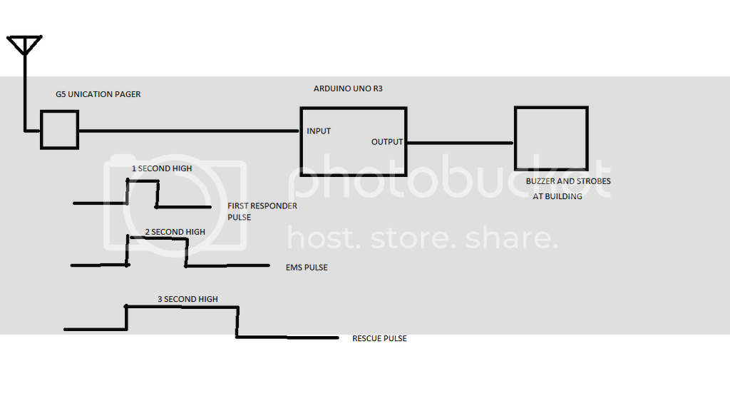

This is a very basic diagram of what we are trying to do. the arduino input could be any of the 3 different pulses in the pics. We are new to arduino and to the code writing stuff so we don't have anything started yet. We are just evaluating if Arduino can deliver a solution to our customer. If arduino receive any of the 3 pulses above it should produce an output that will be preprogrammed for each of the input pulses. Can that be done with code?

Paul, the tones are sent from the 911 center at the county level on a VHF frequency using a A/B tone format for pagers like Motorola. We use a pager (G5) programmed to look for those 3 specific tones that receive the VHF signal with the A/B tones and decode it. From that pager, we are able to get a digital output (HIGH) every time the programmed A/B tones are received. Since is just one output on the pager, we programmed the pager output to be a 1 second HIGH for the First responder tones, a 2 second HIGH for EMS and 3 second HIGH for the Rescue tones. So all the arduino will see is a 1 second HIGH, 2 second HIGH or a 3 second HIGH pulse on the input.
We then need the arduino to react to each pulse with a different output. If it receives a 1 second pulse then the output should do "X" if it receives a 2 second pulse it should do "Y" or if it receives a 3 second pulse it should do "Z". Hopefully :o

Ok, that makes sense. No tone is involved, Just determining the length of time for a "high" signal from the receiver.
The important Arduino features for you to learn, then, are: how to use the millisecond counting feature and how to program a state machine. Both are well described with examples in the tutorials.
Should be an easy program to write, but harder to test without getting the dispatcher involved.
Paul

I have the test equipment to generate the VHF radio signal with the necessary tones and I have the G5 pager to generate the pulses to the input of the arduino. What we are looking for is guidance on how we can write a code so the arduino can scan the input ( digitalRead) and if:

Right track, but you only need to detect when the pulse goes high and when it goes low. And count the time since it went high. Then determine which of the three categories the time falls into.
